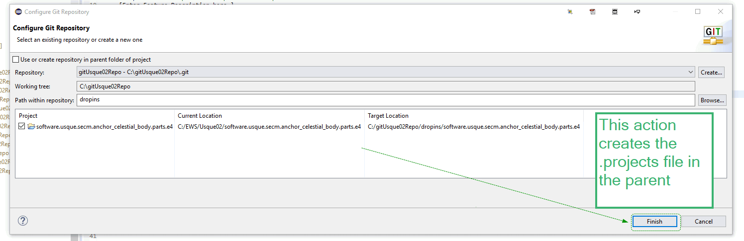

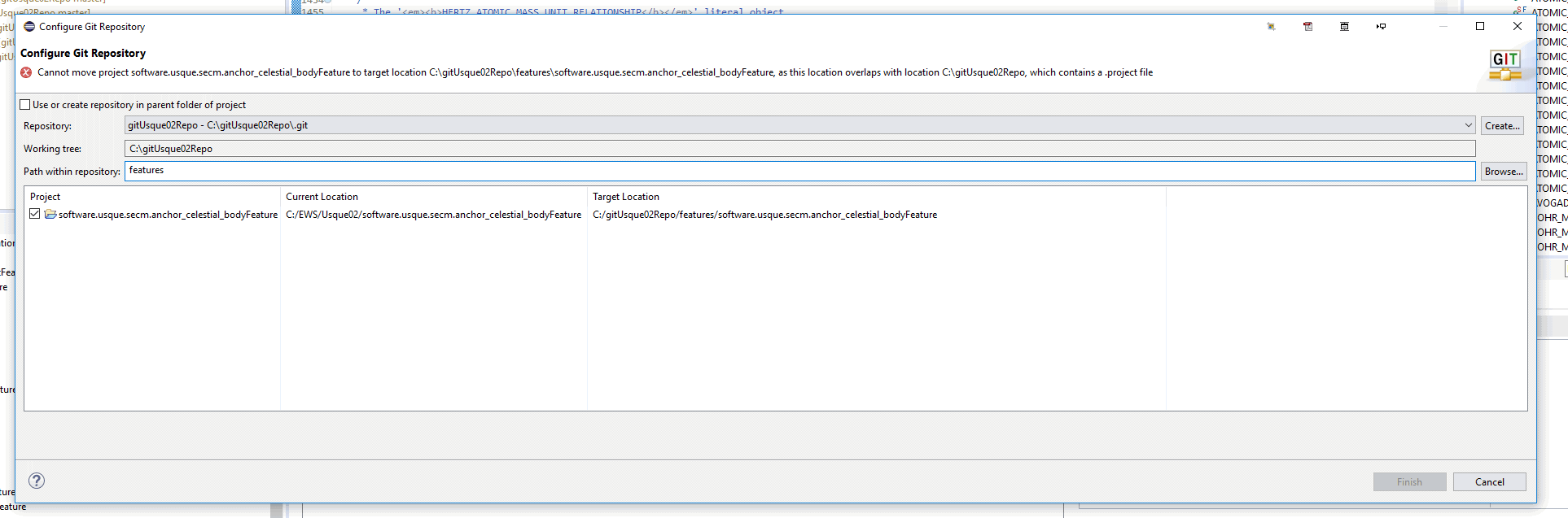

Re: Eclipse Copy/Paste a project under local git control. [message #1786320 is a reply to message #1786283] Mon, 30 April 2018 19:10 Go to previous messageGo to next message
I tried to a Team -> Share Project.
I get errors about there being a .project file in my "Features" folder.
See attached screen captures.

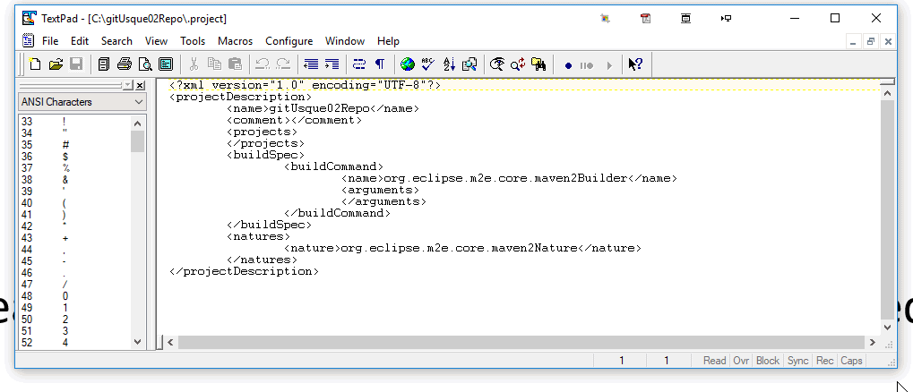

Re: Eclipse Copy/Paste a project under local git control. [message #1786352 is a reply to message #1786320] Tue, 01 May 2018 17:49 Go to previous messageGo to next message
So i looked at prior backups of the my git repository and found that the .project file was not there at the git repository root directory. So it seems that somewhere between Neon and Oxygen this feature/bug got introduced.
The workaround for now is I have to delete the .project file from the parent directory each time a Team -> Share Project action is taken.
Ed do you think this is a bug? Or working as designed? I will open a bug report if you think it is a bug like I do.
Re: Eclipse Copy/Paste a project under local git control. [message #1786361 is a reply to message #1786352] Wed, 02 May 2018 01:13 Go to previous messageGo to next message
In my opinion, sharing a project should not create a .project file in the root of the Git working tree, nor in the parent, folder, nor in any folder. It should simply copy the project's underlying folder (which necessarily contains a .project file) to the folder within the working tree that you target. Only the target folder in the working tree should change...
If you're going to report a bug, which seems reasonable, please be sure to contain all the exact steps required to reproduce it in a fashion that the developers will be able to reproduce it locally...

Re: Eclipse Copy/Paste a project under local git control. [message #1786650 is a reply to message #1786476] Tue, 08 May 2018 19:30 Go to previous message
Cause found.
The parent node of the git repository somehow got added as a project in the eclipse workspace. Because multiple Eclipse Working Sets were in use it was not obvious. Once the parent node of the git repository was delete as a project from eclipse, but not delete from the file system, the behavior stopped.
Bug will be closed.
