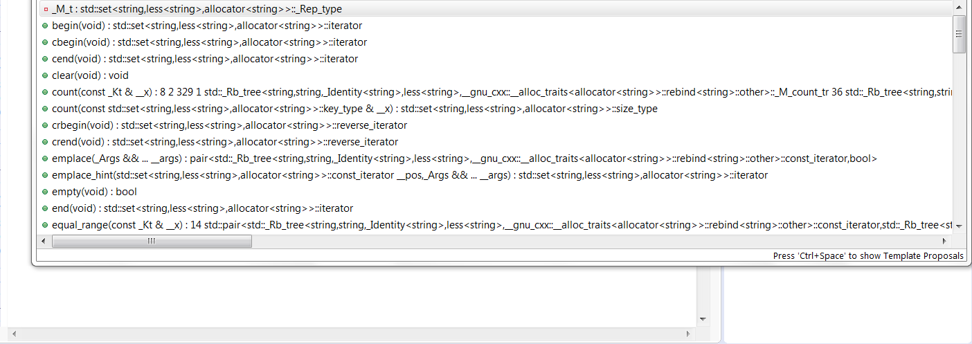

Content assist is useful, but for some reason a lot of the entries it gives me are so unnecessarily long that they become more confusing than helpful.
For example, when I asked for the list of functions I could use for C++'s set<string>, this is what it returns to me.
index.php/fa/32722/0/
How do I trim this down and make it actually readable by a human being? Am I missing a configuration option?

I'm not asking to reduce the number of functions, I'm more confused why the function signatures have so much extra stuff in the types? For instance, I'm fairly certain the "count(const _Kt & ___X)" function signature shouldn't be extending all the way to the end of the assist window. I'm concerned as to why the begin function doesn't say it just returns a data type iterator, instead of... whatever that gigantic signature is. Is this normal for the content assistor?

You are getting: <function> : <return type>
In the case of begin:
FUNCTION: begin(void)
RETURNS: std::set<string,less<string>, allocator<string> > :: iterator
You need the fully qualified type.
iterator by itself doesn't mean anything.
You need to know which one.
std::set<string,less<string>, allocator<string> > is the scope of iterator
Yes, the count function returns an enormous (mindboggling, even) qualified type.
Welcome to the world of C++ and STL.
If you don't like the current output, you could file an enhancement request at
https://bugs.eclipse.org/bugs/enter_bug.cgi?product=CDT
You'll likely need to log in first.
This seems a low priority item so don't hold your breath waiting for a fix.
In the meantime, ignore everything after the first ':' on a line if it's bothersome.
