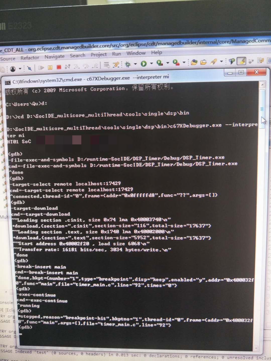

Yes, you are right. I have to create a cross-compiled executable for the DSP. The connection is a remote debug connection.
I'm working on WIn7_x64 arch. The machine is TI's product C6713. The tool is TI's compiler cl6x.
I use the same command is cmd window . It works fine. But when I use these commands in eclipse, eclipse-CDT report an error. please refer to the pic.jpg

Re: CDT Plugin-in Development [message #1786327 is a reply to message #1786212] Tue, 01 May 2018 06:46 Go to previous messageGo to next message
You are not running them in the same way.
In the console application, you have changed to the DSP toolkit binary directory, so the command interpreter knows to run the DSP debugger.
It seems that you have not set up the Eclipse CDT debug configuration to use the proper debugger (and maybe the correct working directory).
Re: CDT Plugin-in Development [message #1786359 is a reply to message #1786327] Tue, 01 May 2018 22:54 Go to previous message
Thanks ! you are right . I edit my debugger working directory . Then it works fine.
