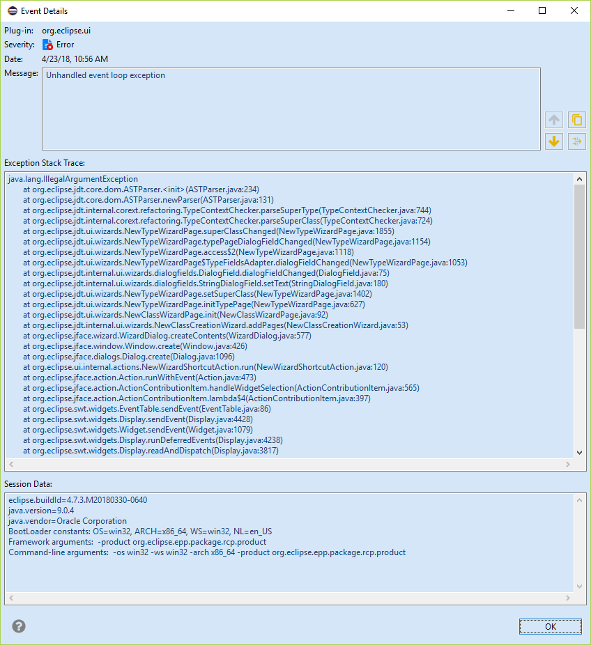

Immediately an "Unhandled event loop exception" appears in the error log.
The file EclipseError.png contains the stack trace from the error log.
The file FullError shows the overall Eclipse state at the time of the error.

What are your default compliance settings in Preferences -> Java -> Compiler? How is your JRE configured in Preferences -> Java -> Installed JREs? The method where the exception is throws looks like this:
	ASTParser(int level) {
		switch(level) {
			case AST.JLS2_INTERNAL:
			case AST.JLS3_INTERNAL:
			case AST.JLS4_INTERNAL:
			case AST.JLS8_INTERNAL:
			case AST.JLS9_INTERNAL:
			case AST.JLS10_INTERNAL:
				break;
			default:
				throw new IllegalArgumentException();
		this.apiLevel = level;
		initializeDefaults();
That suggests to me that somehow it's being called with a level that's not supported by the implementation you actually have. Are you sure you have the latest Oxygen update installed? I ask because the line number of the exception is off by one compared to the version of ASTParser.java that I have, so perhaps you're trying to use Java 10 with a version of JDT that doesn't support that.
