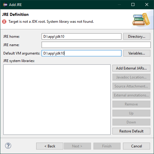

Hi, I was unable to add JRE point to JDK 10.0.1 path. Error " Target is not a JDK root. System library was not found."
index.php/fa/32664/0/

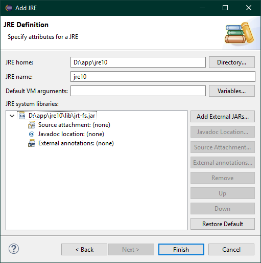

But I managed to add using JRE 10.0.1. But the diff only no source and javadoc attachment which I require to use and study JDK provided objects and functions. Then I need to manually point to the sources and javadoc which available in JDK path.
index.php/fa/32665/0/

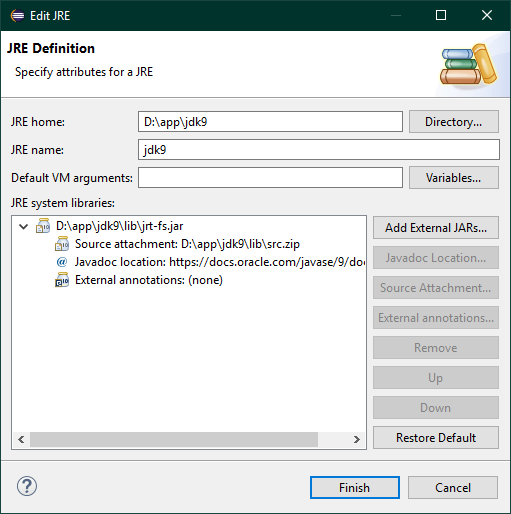

  • Attachment: jdk9.png
    (Size: 18.69KB, Downloaded 5952 times)

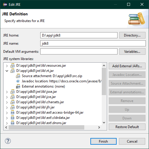

  • Attachment: jdk8.png
    (Size: 22.03KB, Downloaded 6009 times)

Java 9 and beyond, JRE/JDK does not contain jars like rt.jar so you can see only jrt-fs.jar.
If you are pointing to jdk you should be able to see java doc and source attachments.
