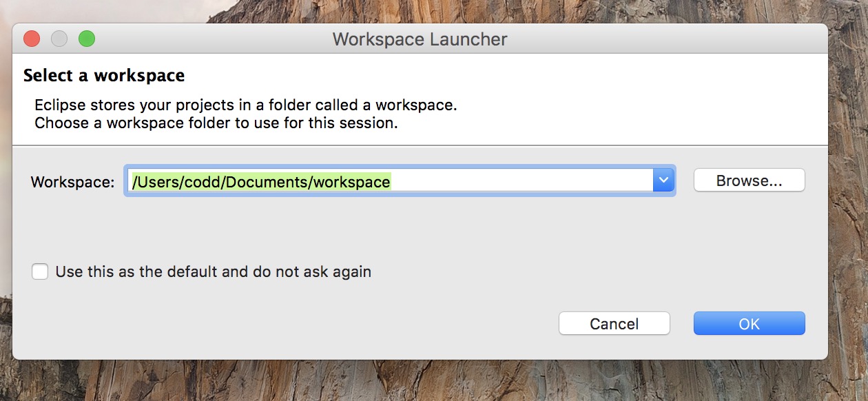

Nearly every time I start Eclipse, it asks where my workspace is and needs to install my plugins all over again.

1) It asks me where my workspace is (Screenshot1.WorkspaceLauncher.jpg), despite the fact that I always check "Use this as the default workspace and do not ask again"
index.php/fa/32631/0/

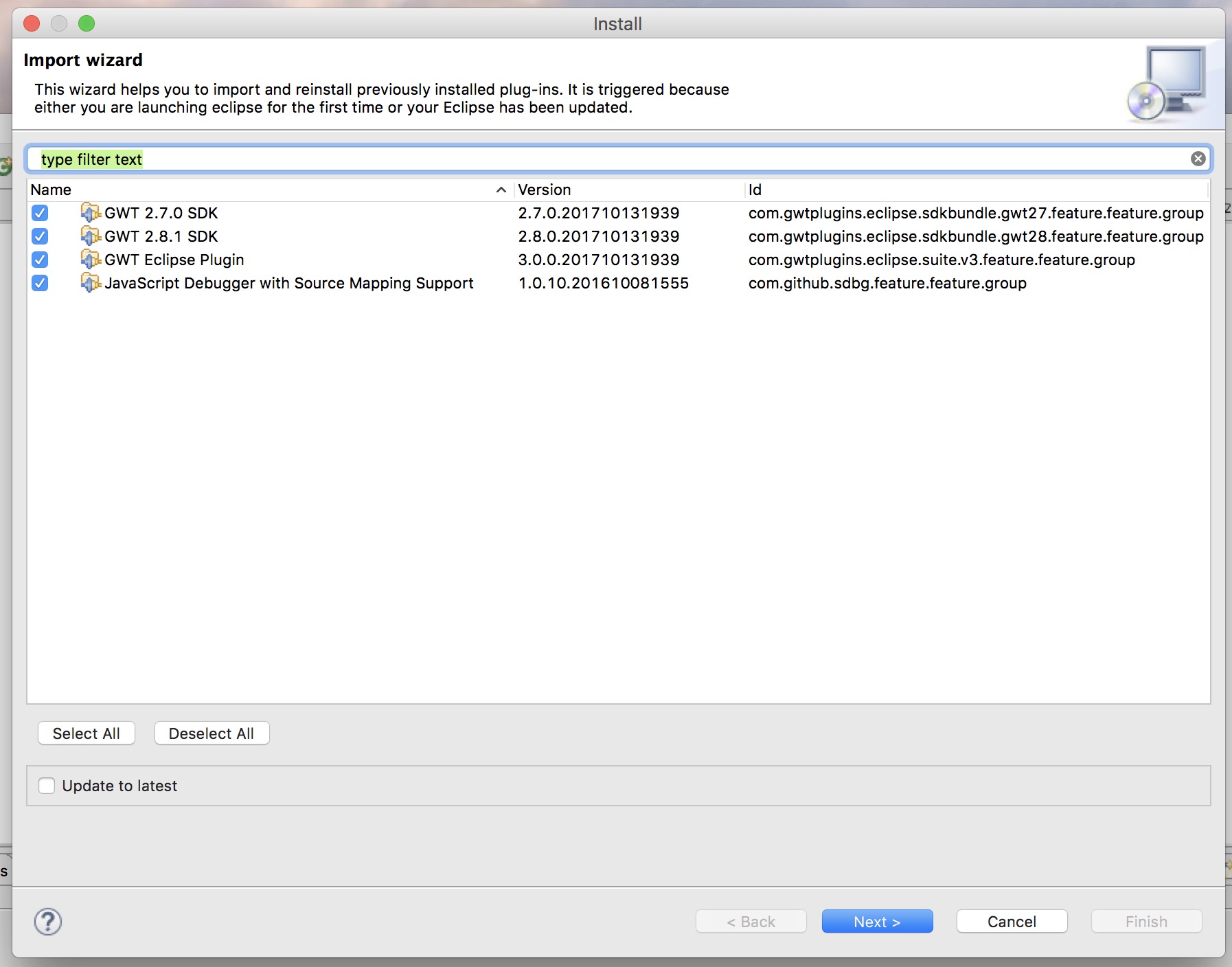

2) It needs to reinstall the GWT plugins (Screenshot3.ImportWizard.Plugins.jpg)
index.php/fa/32633/0/

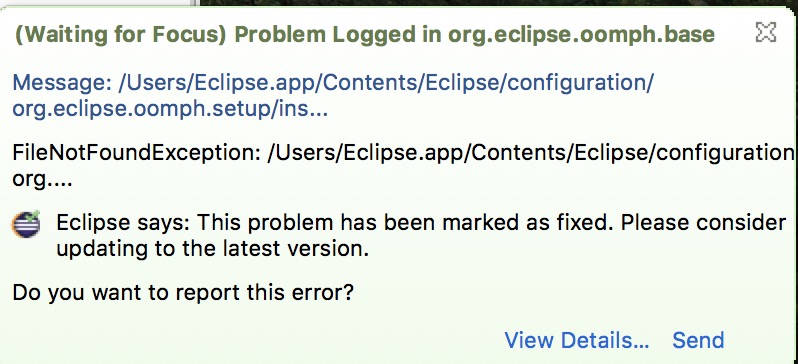

There is also an oomph Exception thrown (sometimes before the import wizard comes up, sometimes after): see Screenshot2.Oomph.jpg)
index.php/fa/32632/0/
Expanding on the cut off text: FileNotFoundException: /Users/Eclipse.app/Contents/Eclipse/configuration/org.eclipse.oomph.setup/installation.setup (No such file or directory)
I suspect this is the root cause, as that is not where Eclipse.app lives. Not sure why oomph is looking there.
