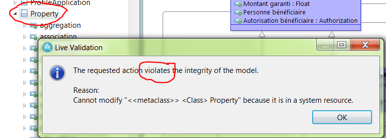

I tried to modify the Property object in the Profile applied to the UML model but it reports a violation error.
How to extend the Property object in the metamodel ?
Thank you, José

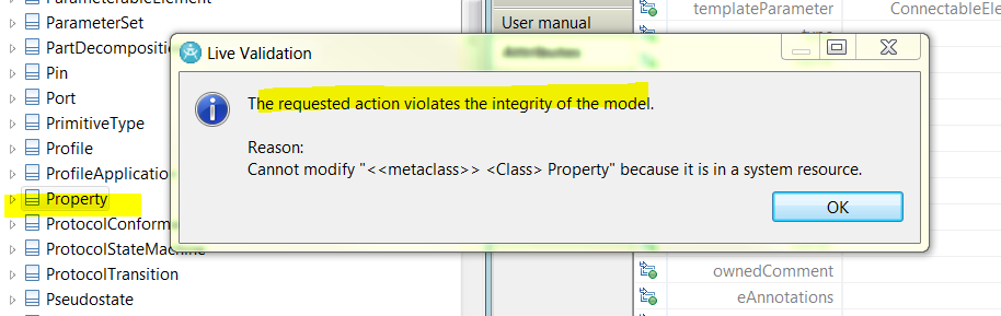

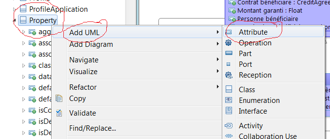

Ok,
1) I have attached 5 screenshots for each step leading to the violation
2) "rather than a Property instance in your UML model" => in fact i need to attach special information to each instance of property (around 1500) in my model. This information must not be produced by the java transformer. This information is not part of the model and must not be delivered to our clients (application written in java)
Thank you, José

From your screenshots it seems that you are trying to directly modify the UML metamodel, this is not really "Lightweight".
In your first post you mentioned you wanted to use the "Lightweight extension" approach, that means defining and using a profile. To "attach" information to a property, you create a profile, and you define an stereotype that applies to metaclass "Property" and then you add attributes to the stereotype (not to the metaclass).
