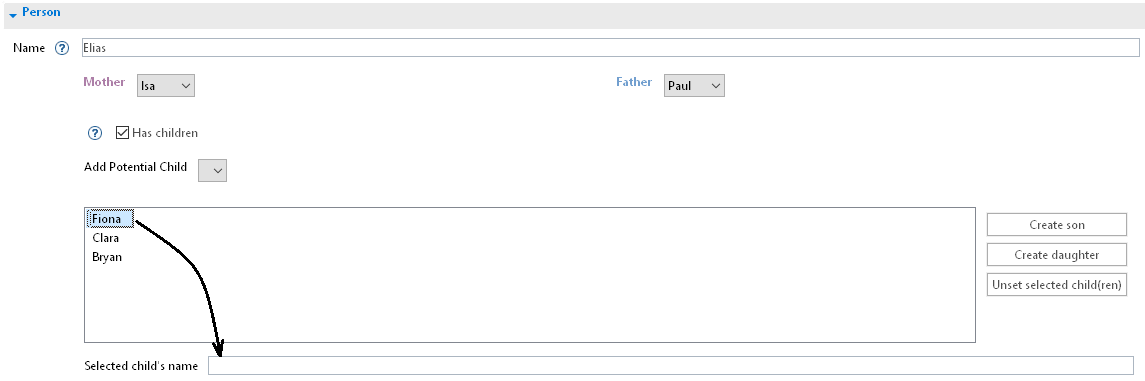

Is it possible to have a list widget in a properties view and when an item is selected, the text widgets below are updated with the selection?
For example, with the Family example, when a child is selected in the Children list, would it be possible to have a Text widget below that allow to change the name of the selected child?

It is not possible with widgets proposed by Sirius.
So you will have to create your own widget and integrate it to Sirius by following documentation at https://www.eclipse.org/sirius/doc/developer/extensions-properties_provide_custom_widget.html
If you choose to do the advanced integration you have an exemple with the reference widget.
Just take a look at all plugins containing widgets.reference in Sirius source code.
