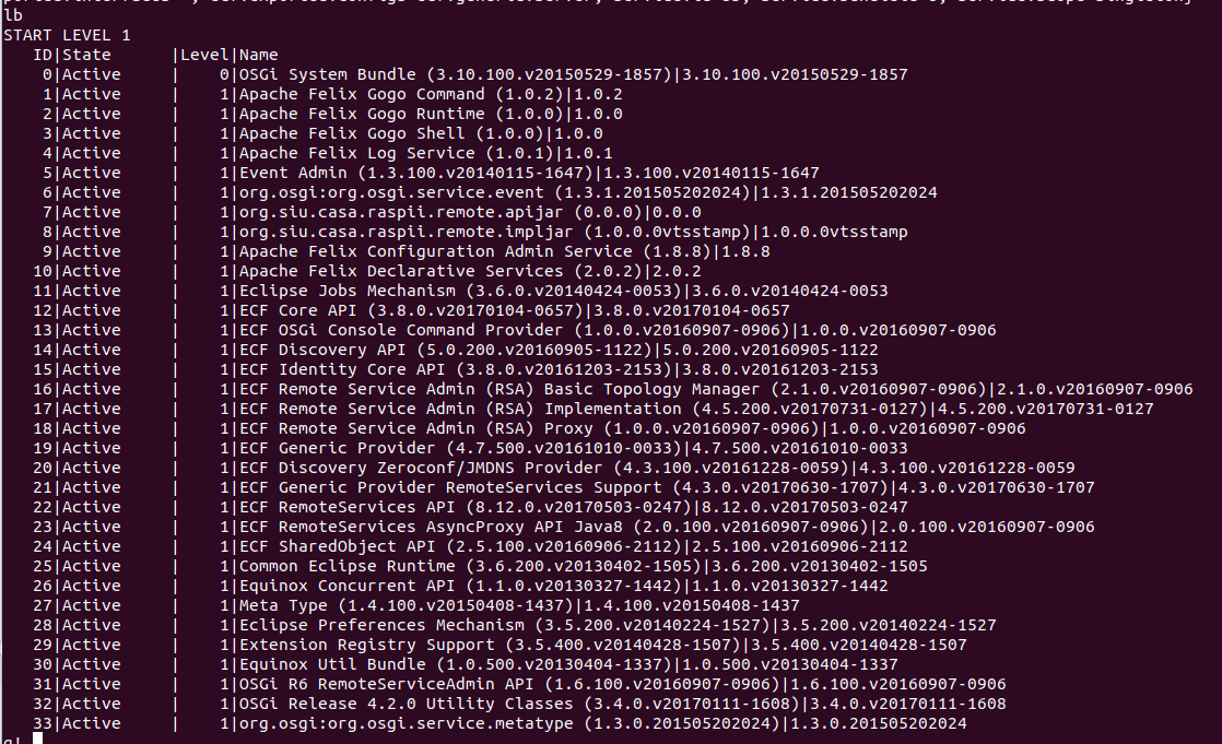

Hello, I have been following the OSGI remote services tutorial using ECF. Primarily, I manage my bundles using bndtools in eclipse. My question is regarding necessary bundles both in the service host and service consumer side in order for a generic service discovery and usage to work. Here's a copy of my host's bndrun file, which is of course not registering any service remotely. Also, I wanted more information for service discovery in the client side. Running the same bundles in the client side leads to null pointer exception.
To be specific, what bundles should I run on both service host and client side for remoting? Also, should I change my bundle start level for ECF bundles?
A screenshot of my bundles running in Raspii is also attached.
index.php/fa/32597/0/

After a quick reorganization of bundles, I got the following exception.
Exception in thread "BasicTopologyManagerPreRegSrvExporter" java.lang.IllegalArgumentException: Failed to select host container
at org.eclipse.ecf.osgi.services.remoteserviceadmin.RemoteServiceAdmin.exportService(RemoteServiceAdmin.java:349)
at org.eclipse.ecf.osgi.services.remoteserviceadmin.AbstractTopologyManager.handleServiceRegistering(AbstractTopologyManager.java:466)
at org.eclipse.ecf.internal.osgi.services.distribution.BasicTopologyManagerImpl.access$0(BasicTopologyManagerImpl.java:1)
at org.eclipse.ecf.internal.osgi.services.distribution.BasicTopologyManagerImpl$1.run(BasicTopologyManagerImpl.java:90)
at java.lang.Thread.run(Thread.java:745)
Caused by: org.eclipse.ecf.osgi.services.remoteserviceadmin.SelectContainerException: Container does not implement IRemoteServiceContainerAdapter

Re: ECF Bundles for service discovery in OSGI with Bnd tools [message #1785349 is a reply to message #1785342] Thu, 12 April 2018 16:09 Go to previous messageGo to next message
Hi Umesh,
Your timing on this question is very good. I'm almost completed with an effort that I've been engaged into to
a) Make it easier to consume ECF RS from bndtools-based projects
b) Deal with the problem you are apparently experiencing wrt start levels
Let me explain b. First, I believe that you have all the necessary bundles for both remote service host and remote service client when running.
In previous versions of ECF it was necessary to have the ECF impl of RSA (bundle: org.eclipse.ecf.osgi.service.remoteserviceadmin) be started *after* any distribution providers (e.g. the ecf.generic.server provider). The reason for this is complicated (e.g. has to do with lazy start in Eclipse and using declarative services or not), but the upshot was that now it's no longer necessary to set start levels to get everything started in appropriate order.
For your use case, you can either:
Start this bundle at a start level *before* all others: org.eclipse.equinox.common
and start these two bundles *after* all the others:
org.eclipse.ecf.osgi.services.distribution

Re: ECF Bundles for service discovery in OSGI with Bnd tools [message #1785350 is a reply to message #1785341] Thu, 12 April 2018 16:18 Go to previous messageGo to next message
One more comment:
On Felix it's necessary to also include an 'equinox supplement bundle:
org.eclipse.equinox.supplement
The easiest way to see the bundles necessary for felix is to consult the karaf-feature.xml:
http://download.eclipse.org/rt/ecf/3.13.8/karaf-features.xml
I suggest you consult this list
Also, in your list, I do not think the following are needed/can be removed:
28 Eclipse Preferences Mechanism
29 Eclipse Extension Registry Support
When you move to the Photon version of ECF, you will probably also want to include a new bundle:
org.eclipse.ecf.osgi.services.remoteserviceadmin.console
I haven't put together the Photon release karaf-features.xml, but I will do that prior to release.
This will provide console commands for the ECF RSA implementation.
