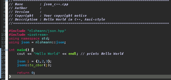

Works for me.
I cloned the github entries to /home/dvavra/proj/json.
Then added -I/home/dvavra/proj/json/include
I also placed a link to json.hpp in my project source.
Otherwise, i would have had to include "nlohmann/json.hpp" (as shown)
instead of simply "json.hpp"

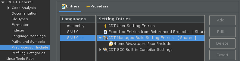

After the first build it showed up in
Project --> Properties --> C/C++ General --> Preprocessor Include Paths, Macros etc. --> Entries tab --> CDT Managed Build Settings Entries
index.php/fa/32680/0/
If you want the indexer to work before any builds then add <path to git clone>/include as a User Entry.

FWIW: I created the project with
File --> New --> C++ Project --> Hello World C++ Project
