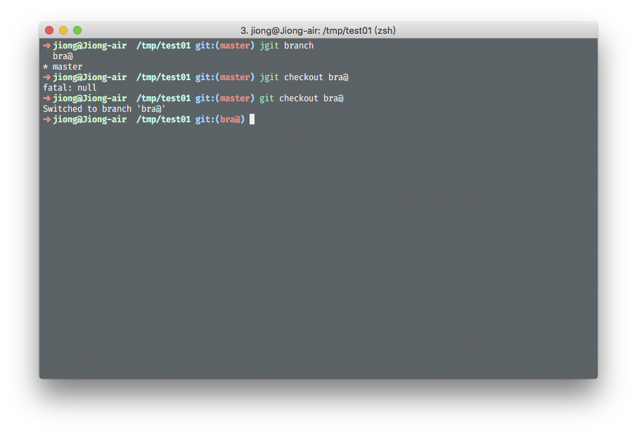

Jgit can't check out the name contains @ branch [message #1785030] Sun, 08 April 2018 04:41 Go to next message

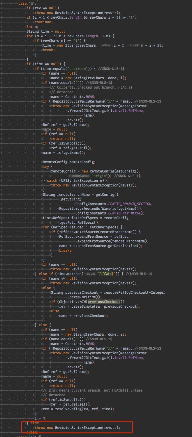

I check the code.
I find it.
index.php/fa/32558/0/
Re: Jgit can't check out the name contains @ branch [message #1785284 is a reply to message #1785030] Thu, 12 April 2018 02:26 Go to previous messageGo to next message
That's right. JGit is not supporting branch names containing @ as last char. If it is not the last char like in test@1 then it works. I think that's a bug. Problematic is [1]. I'll propose a fix for that.
[1] https://github.com/eclipse/jgit/blob/v4.11.0.201803080745-r/org.eclipse.jgit/src/org/eclipse/jgit/lib/Repository.java#L689-690
Re: Jgit can't check out the name contains @ branch [message #1785295 is a reply to message #1785284] Thu, 12 April 2018 04:05 Go to previous messageGo to next message
see https://git.eclipse.org/r/#/c/121042/
Re: Jgit can't check out the name contains @ branch [message #1786752 is a reply to message #1785295] Thu, 10 May 2018 11:08 Go to previous message
This fix was merged to the master branch and will be included in JGit 5.0.0
