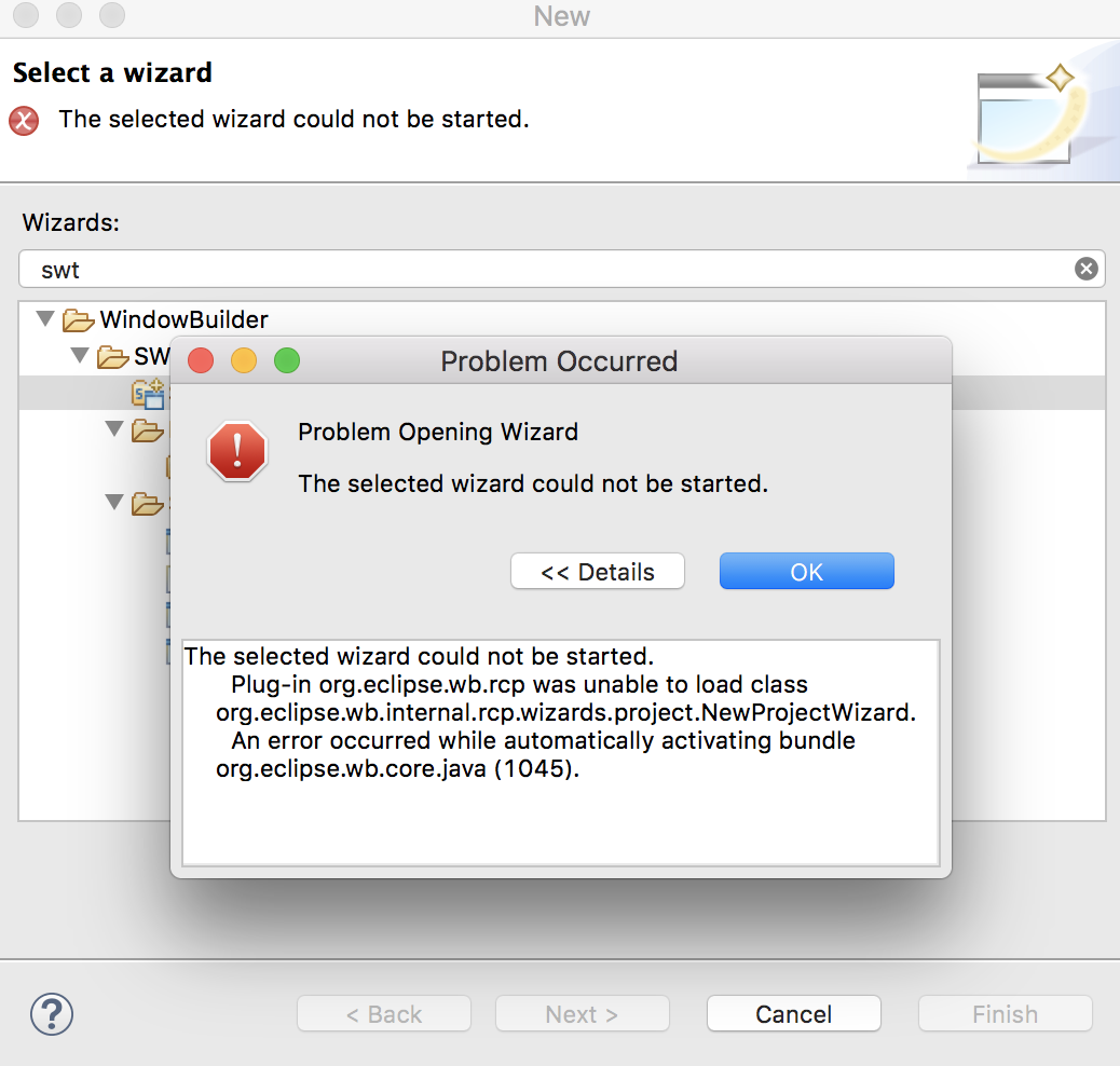

I run Eclipse Oxygen on my MacOS Sierra. And install the SWT in it with the instruction of below link:
http://www.eclipse.org/windowbuilder/download.php
i'm sure install the right version of SWT aligned with Oxygen.
But still with the error message, screenshot as attached.
index.php/fa/32537/0/
I also tested with other Eclipse version like Mars. But still have problem. Is my MacOS not support it? Or not correctly installed?
Really appreciate if any help.
Best Regards
Willian

What version of java are you using? As far as I am aware, WindowBuilder doesn't work with Java 9 and above.
