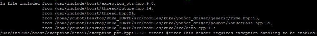

I'm trying to generate the binaries for FORTE but when I start the making process, it gives back the following error
exception_ptr.hpp:17:2: error: #error This header requires exception handling to be enabled.

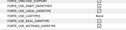

index.php/fa/32532/0/
According to me I'm correctly enabling the exceptions handling flag, but apparently that's the opposite from truth. Does anyone know how to correctly enable the exceptions handling in a CMakeLists.txt file?

hi, I hope it is ok if I answer just in this thread.
Per default we are deactivating in on of the cmake files all RTTI and exception support the main reason still is the performance and code size for very small embedded systems. However we have a cmake flag called FORTE_RTTI_AND_EXCEPTIONS in the advanced section which allows you to turn on exceptions.
by added "set(FORTE_RTTI_AND_EXCEPTIONS true)" exception should be enabled for forte this at least what i hope.

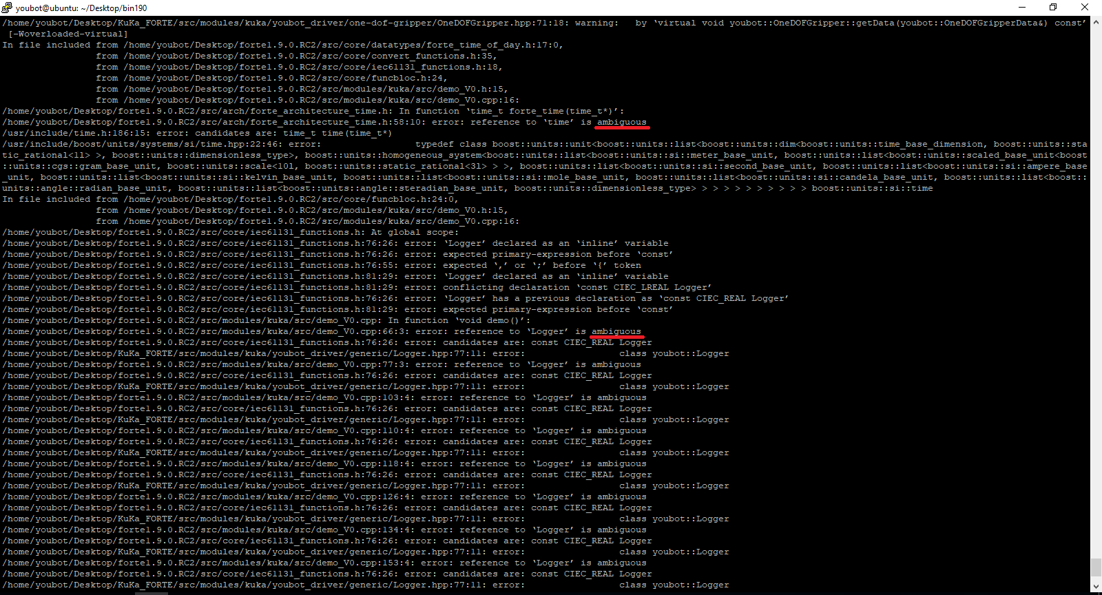

index.php/fa/32550/0/
My next questions are the following:
Is there any method to compile FORTE while some of the functions share variables names inside their codes?
Is there any command to let CMake know which library use to compile a specific program?

hi, please try to avoid changing offical forte files. This will make it extremly hard for you on the long run to update to newer forte versions. you can also set this flags from the CMake gui when clicking on the advanced checkbox.
Regarding your errors for me it seems that you are using a lot the using namespace option. Therefore you get types and variables with the same name.

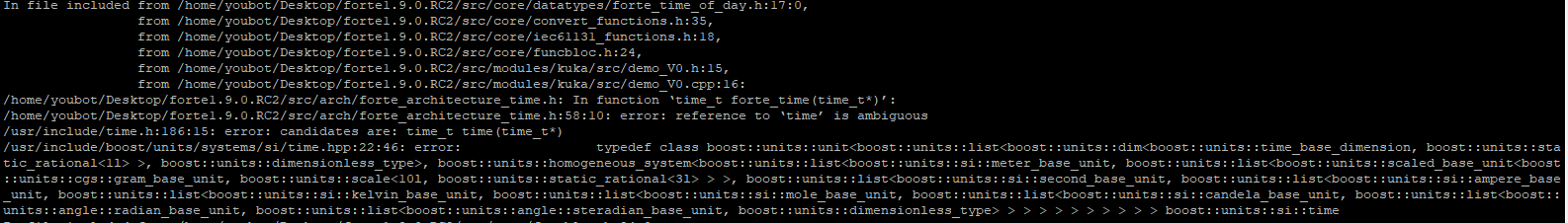

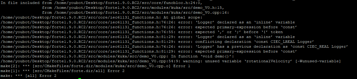

Right now I only have two errors left, but they seem to be generated in the FORTE core libraries. The only hypothesis that comes to my mind about the error is that there's a collision between the boost library and some FORTE libraries, but I got out of ideas of how to solve them. Any suggestion that you can come up with?

The first error is rather strange for me as forte is using here just standard C/C++ posix libraries. But it still looks like a name space clash. A potential solution could be to change the line 58 in forte_architecture_time.h to: return ::time(pa_time);
The second error seams to be that the LOG function defined in IEC 61131-3 is changed by a preprocessor define to Logger. This is definitely an include order issue. See my comment below.
Without seeing your code I would assume that it has something todo with include orders. Please make sure that forte core includes are at the beginning.
Furthermore a common error that I notice in C++ is that too many includes are done in the .h file.

In the end the way to solve those 2 remaining problems was by reordering the include orders. I was wrongly including the forte core includes after the libs that I made. After changing the order....

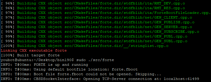

index.php/fa/32583/0/
Once again thank you so much for your help! And if by a chance one day you end up in Ecuador, let me know and I'll invite you a ceviche!
