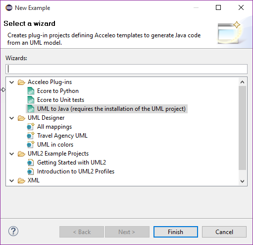

I need to use the generate Java code from an UML model, and to launch the generation of my Java beans using this generation module I need a ".uml" model as the input, wanted to use the one provided in the UML to Java Acceleo example (File -> New -> Example -> Acceleo plug-in -> UML to Java) but instead it tells me that it requires the installation of the UML project!
I dont get it!
please help and thank u
  • Attachment: UML2java.png
    (Size: 30.01KB, Downloaded 275 times)
Re: UML2JAVA [message #1784507 is a reply to message #1784496] Wed, 28 March 2018 15:45 Go to previous messageGo to next message
1) UML.ecore is in the UML project
2) The model support for *.uml is in the UMLproject
You might just survive without 2, but not 1. You are kind of expecting *.java files to execute while refusing to install a JVM.

If you had started with the Eclipse Modeling Package you would already have the Eclipse UML2 project. You can add it by
Help -> Install New Software...
Work with: http://download.eclipse.org/releases/oxygen
Modeling -> UML2 Extender SDK
Next ...
