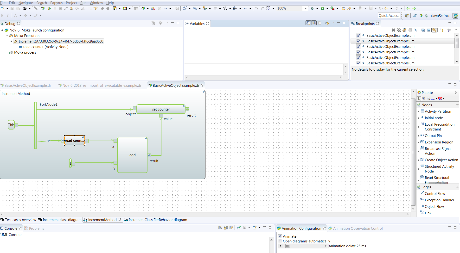

I now have the BasicActiveObjectExample running and animating. However, no breakpoints appear to work. I have tried setting breakpoints on items labeled [Activity Edge] and those labeled [Activity Node], yet Moka never hits the breakpoints.
I have attached an image of the incrementMethod showing multiple blue dots.
I do notice something interesting in the "Breakpoints" tab. Each breakpoint is listed as "BasicActiveObjectExample.uml". This is also shown in the attached image.
This is unlike the ModelExecution tutorial where the breakpoint tab shows things like " ObjectFlow5" and "read counter".

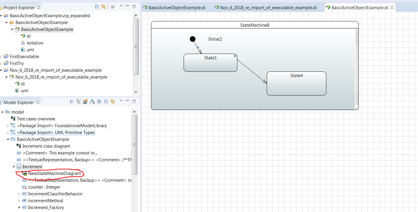

I have now tried to add a very simple state machine.
See attached image.
I then re-generated the Increment_Factory.

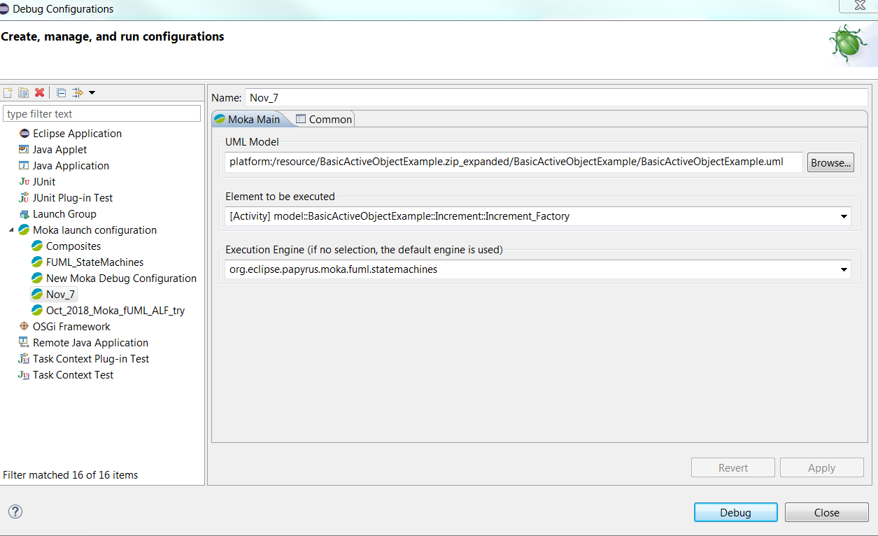

I then created a new Debug Configuration using org.eclipse.papyrus.moka.fuml.statemachines
as the Execution Engine. See attached image.
The statemachine did not animate. Both the IncrementClassifierBehavior diagram and the incrementMethod did animate.
