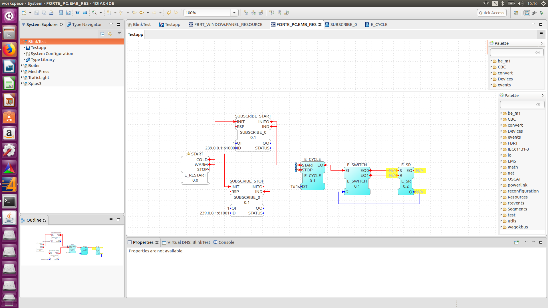

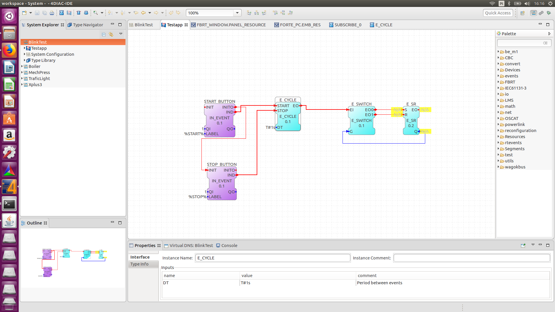

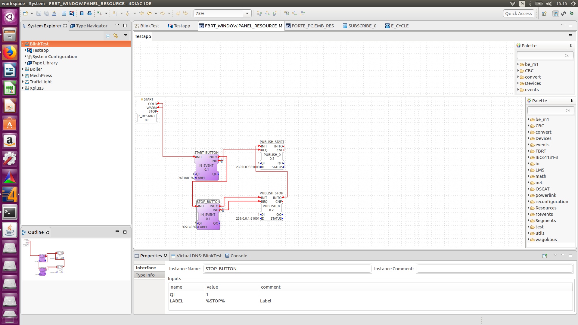

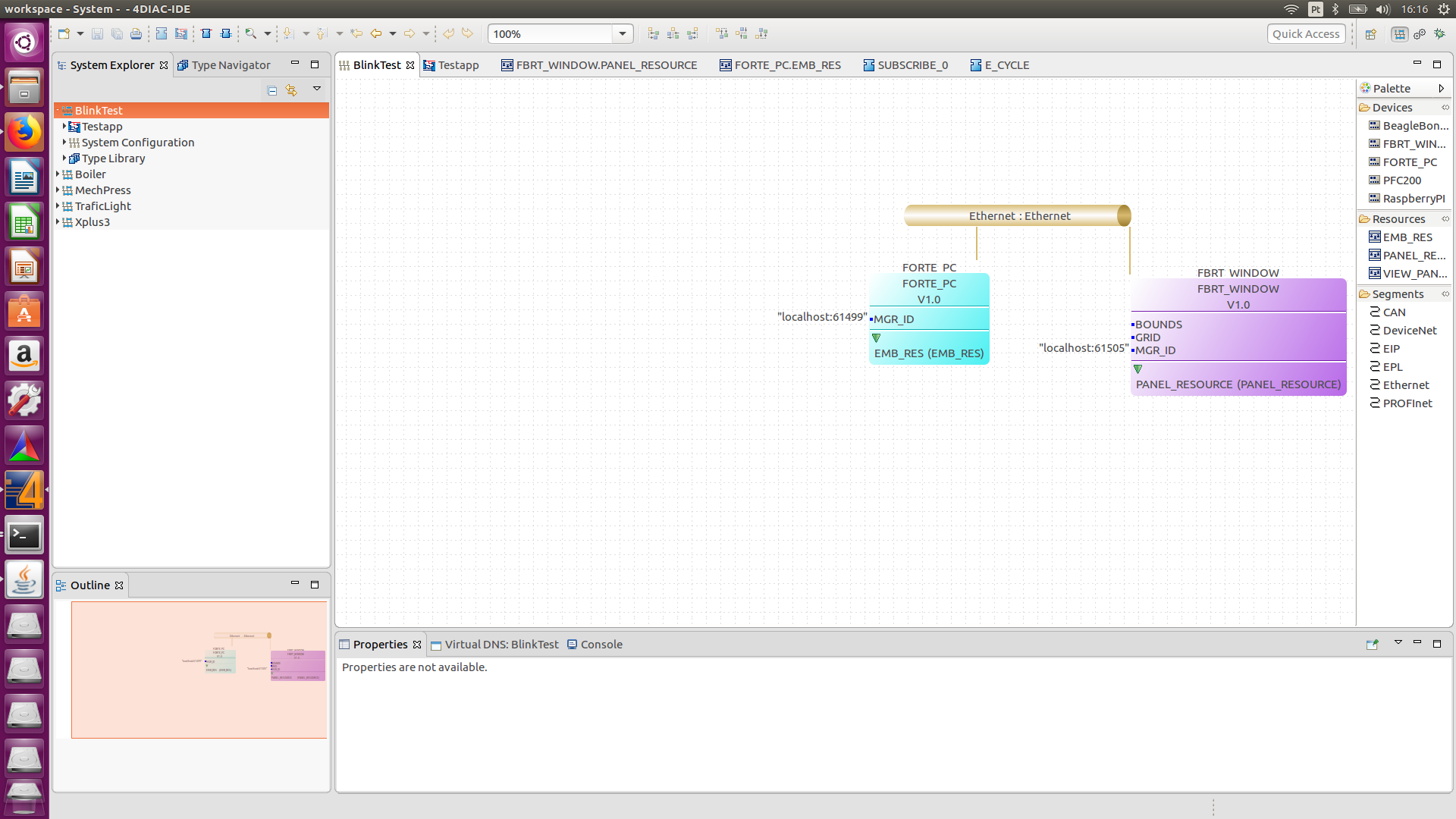

Hi, its me again. I'm following the distributed application example available at https://www.eclipse.org/4diac/documentation/html/4diacIDE/distribute4diac.html
after the deployment process i got this on my console:
WARNING: T#01000ms: Boot file forte.fboot could not be opened
INFO: T#01000ms: CBSDSocketInterface: Opening TCP-Server connection at: localhost:61499
INFO: T#01999ms: FORTE is up and running
INFO: T#013790ms: CBSDSocketInterface: Opening UDP receiving connection at: 239.0.0.1:61000
INFO: T#013790ms: CBSDSocketInterface: Opening UDP receiving connection at: 239.0.0.1:61001
INFO: T#014790ms: Connection closed by peer
Some pictures of my system are attached in this post.
I'm using Ubuntu 16 and 4diac ide 1.8.4 and forte. I also have followed the build guide for the installation.

The download went perfeclty fine. The conneciton closed by peer message is just to inform you that the IDE closed the connection with the devices. However you don't see any values as you need to explicitly turn the monitoring on. Please see in the docs for more information on that.
