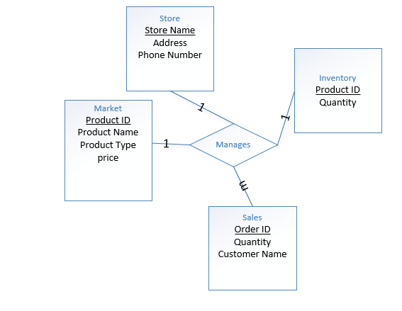

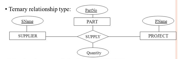

Well as the title says, i would like someone could post an step by step or "mini-how to" in order to include nary relationships in a class diagram using Papyrus.

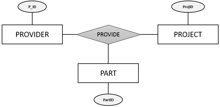

Also would be nice to add also a association class (if its possible) like date in relation manage in the example below or quantity in the provide association.
Thanks in advance
Some classic examples:

Example using association class quantity:

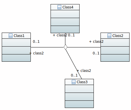

Hi Eduardo,
You should start with a simple binary association, then add "Association branches" to connect the remaining nodes:
index.php/fa/32413/0/

Re: How to design n-ary relations in Papyrus [message #1784074 is a reply to message #1784072] Thu, 22 March 2018 05:32 Go to previous messageGo to next message
Thanks and i suppose to add an association class would be the same ??
Re: How to design n-ary relations in Papyrus [message #1784078 is a reply to message #1784074] Thu, 22 March 2018 05:59 Go to previous messageGo to next message
Association class should be drawn first (Instead of creating a binary Association, you create a Binary AssociationClass). However, it seems that NAry Association Classes don't work well (The diamond is displayed as a square, and the dashed-link from the AssociationClass disappears).
Camille
Re: How to design n-ary relations in Papyrus [message #1784178 is a reply to message #1784078] Fri, 23 March 2018 05:01 Go to previous messageGo to next message
Id try it later....thanks for your answer.... Im supposed to report a bug ? Or it would be some workaround in papyrus devs about this ??
