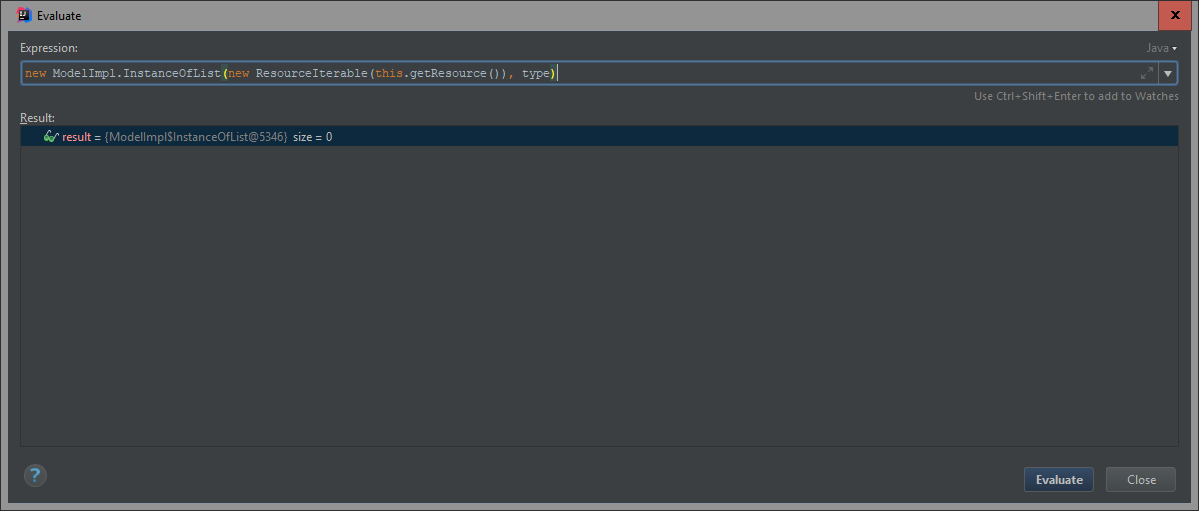

So I've tried to use the EMFTVM compiler to create a transformation programatically in a standalone application, as in this example https://github.com/guana/ATLauncher. Now where my implementation differs is that I generate my metamodels programatically from class definitions, not from .ecore files, and I instantiate my input model from an object, not from a .xmi file. I've written my own parsing functions (see attachment) to do this.

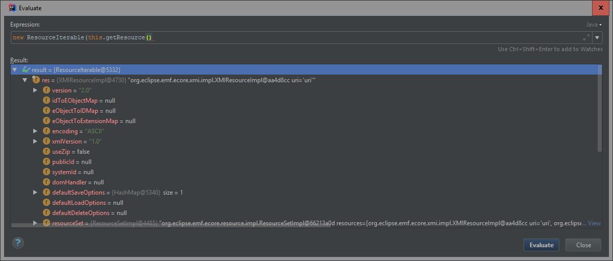

Now when I run the transformation it doesn't give me any exceptions, but it gives me an empty output model. I've debugged the code into the EMFTVM source code and compared it to the execution of Guana's off-the-shelf launcher, to see where it differs. One difference I've found is that, in my implementation, the function allInstancesOf() in the ModelImpl generates an empty InstanceOfList for the ResourceIterable of my inputmodel resource (see pictures in attachment). I'm thinking this might cause the problem, but I have no clue how to fix it.

Can you check in the debugger if there exist multiple instances of the metamodel/EClasses in memory? Aliasing problems are common in EMF, whenever the metamodel is loaded explicitly. EMF may choose to auto-load its own instance of the metamodel when loading the input model. ATL/EMFTVM will then not find any instances of the explicitly loaded EClasses, because the input model elements all point to different instances of the same EClass.
