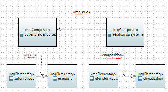

Hi, i have created a model and appling my profil on it
and now i want to get the name of relationship between requirements wich are in red and i don't know how to do it in an acceleo template

If you provide a repro (zipped project) representing your best, no doubt failing, attempt, I can try to help you make it better.
However, I'm sorry that I do not have time to guess at what you are trying to do and what you have tried to do.

Sir @Ed Willink here is my project my profil (papyrus project )where you'll find the model
an my trans (acceleo project) where i want to get the name of relationship

Your first problem is that you have ignored the TODO at the foot of Generate.java to register your models.
For UML this is now trivially achieved by
UMLResourcesUtil.init(resourceSet);
(The next release of Acceleo is likely to have better comments that make this secret explicit.).
Unfortunately you are using SysML for which no one has yet provided a SysMLResourcesUtil.init(resourceSet) - see recent threads such as "unable get SysML stereotypes".
I am sorry, I am not a SysML (or even Acceleo) user and do not have time to go that far away from my OCL/QVT interests. I raised https://bugs.eclipse.org/bugs/show_bug.cgi?id=531840 to try to make some progress on this FAQ.
