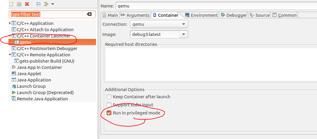

Trying to debug C++ app remotely from Ubuntu 16.04 in Eclipse oxygen, compiled for x86_64 target, on a remote docker container that has a gdb server (also compiled for x86_64 target).
Running in priviliged mode.
The debug fails with an error message:

the debug configuration snapshot is attached.
