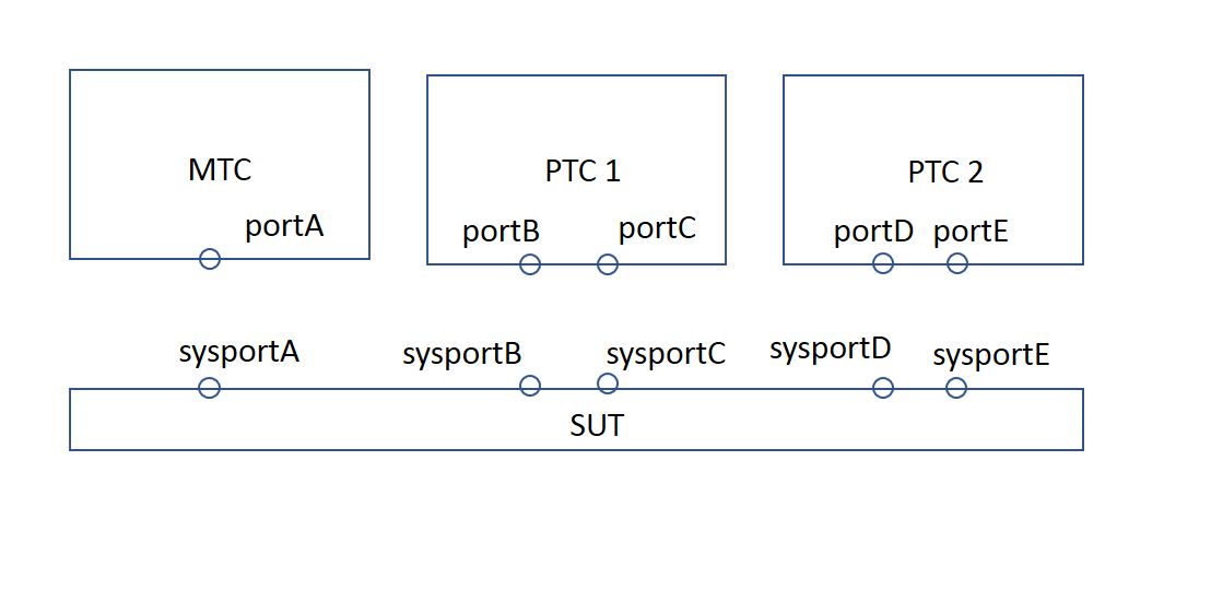

By default a translation port is mapped to the empty skeleton/direct port if the system clause, config file etc, are not consistent; in such a situation the compiler issues a note as it cannot be certain if this is intentional or not.
So please check this first.
I'm not sure what you mean by SYSTEM being nested in MTC, but it does not sound right.
The system component represents the system under test and it mirrors the ports of all the components, see figure;
index.php/fa/32620/0/
Here you need to map MTC:portA to system:sysportA, PTC1:portB to system:sysportB etc.
The component ports are abstract ports , while the system ports are the matching physical ports .
For simple ports both component ports and system ports are of the same type (e.g. UDPasp_PT) and system component declaration can be forgotten (though I prefer to do it for clarity) as the compiler will assume it.
For translation ports the component ports are of one type,
in your case IPL4_MTC_System_Ut_PT

and system ports are of the type to which the upper port is mapped
(in your case IPL4asp_PT)
and declaring a system component is compulsory else translation will not work (the port will bind to an empty internal skeleton)
Also every function, test case etc. which refers to mapping the translation ports will have to have the right 'runs on' and 'system' clause, or , again, translation will not work.
I know the translation ports are a bit fussy, but they offer the huge advantage of reusing a lower layer port for higher level protocols.
I hope this made it a bit clearer.

Re: Encoding function for 3GPP RLC/PDCP PDUs [message #1786063 is a reply to message #1786041] Wed, 25 April 2018 02:00 Go to previous messageGo to next message
Hi Andre,
If you have only one connection/association per port at one time, which I think might be your case , then you might not need to use the f_IPL4_connect ;
Let me repeat an earlier entry:
If you expect to have only one UDP ( or TCP) channel along the duration of your test case, you can use the following simplification:
the connection can be controlled not only from f_openConnection, but directly from the map operation , meaning that when mapped, the port will open automatically a connection with parameters taken from the config file;
if , on top of that , lazy_conn_id_handling is set to yes (and only one comms channel in the system, which can be unequivocally referred to) ,
then the user does not have to care about the real value of the connection id , the dummy value -1 can be used instead.
This means that you can skip the f_openConnectionFunction but have to use in the config file something like:
*.portName.defaultListeningPort				:= "0"
*.portName.map_behavior					:= "connect"
*.portName.RemotePort						:= "666"			 // SUT - Port
*.portName.RemoteHost						:= "127.0.0.1"   // SUT - IP
*.portName.lazy_conn_id_handling			       := "yes"
*.portName.debug                                                     := "yes" //or "no"
*.mccPort.map_protocol                                           := "udp"
For obvious reasons this setup can handle one connection only ; with f_connect() , f_close() etc. , any number of connections can be opened or closed flexibly at any moment.
In this case, connect is called implicitly when the port is mapped.
So maybe this is the way to go in your case. Try it with one port first to see how it works.
Otherwise you will have to add f_IPL4_connect to the appropriate sections of the functions running on PTC's which might force you to re-edit the code
-which is coming from elsewhere -anytime it changes.
Please let me now if this helps.
Best regards
Elemer
