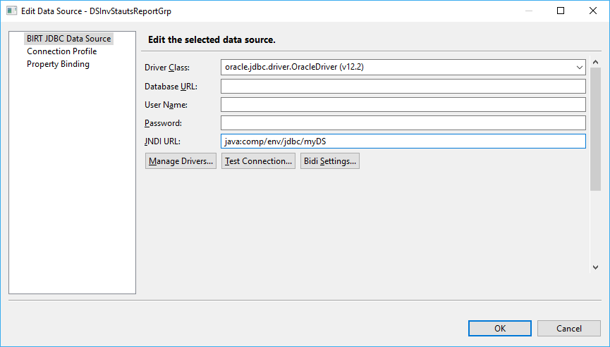

I am new in Birt, I have deployed birt runtime on weblogic and I am using Birts JNDI connection to connect it with datasource.
Please find attached screenshots of Birt Datasource and Weblogic Datasource.
Birt Report Datasource
index.php/fa/32288/0/

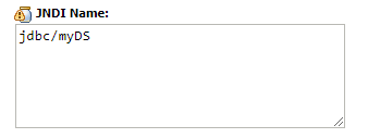

Weblogic Datasource's JNDI Name
index.php/fa/32290/0/

Hi jiabir yu,
I solved the problem by writing jdbc/myDS in Birt JNDI URL.
Hope it will work for you.
