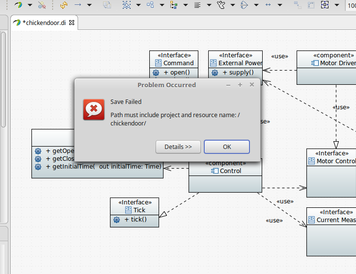

Very often after assignment of a stereotype to a component I am not able to save the component diagram.
It happens in a first example project that I am preparing.
I can repeat the problem with any new Papyrus project:
I created a very simple profile.
Restart Eclipse - just to be sure the profile is known.
I create a new Papyrus project, add a component diagram put a component on there. Still able to save the diagram.
Now when I try to assign a stereotype to that component, but miss it, because I click only one time instead of double-click, and try to save, I get the message: "Save Failed
Path must include project and resource name: /<the projects name>/"
I googled, saw that this happened before, but did not find any numbered issue, solution, or workaround.
My workaround was, to save the diagram as a picture, restart Eclipse and repeat the changes. Attached you may find the profile and a simple application together with a screenshot of the failure message.
I am using Oxygen 2, updated today, on Debian Jessie (LMDE 2) and Java-9.
Any other idea to cope with this problem?
