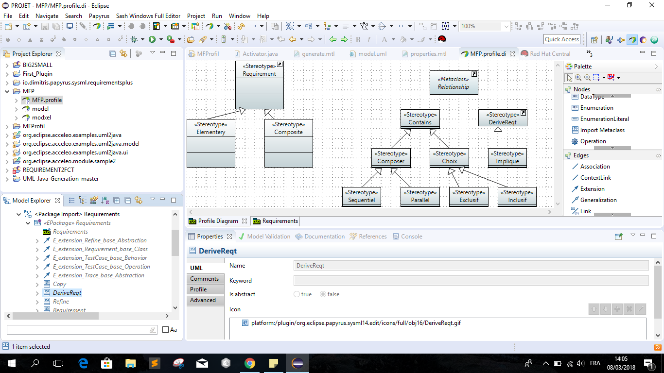

Hi, I need help please
i want to link the metaclass relationship with the stereotype requirement with an association
and even the metaclass with the stereotype derivereq and contains with generalization but i can't do it i don't know why !!
Re: Association between metaclass and stereotype [message #1783143 is a reply to message #1783141] Thu, 08 March 2018 08:27 Go to previous messageGo to next message
It seems that Requirement is an imported element. This probably means that it is read-only, thus you can't add a new association on that element (Although it might be possible to actually create that association, if both members ends are "owned by association". But I don't think you can create such an association from the Profile Diagram)
You may try to make the Requirement explicitly writable (On the Requirement stereotype: right click > Enable write), then create the association.
Cheers,
Camille
Re: Association between metaclass and stereotype [message #1783156 is a reply to message #1783143] Thu, 08 March 2018 10:18 Go to previous message
Hi I remark that you create a new profile.
You want to specialize Requirement and it links.
Why do you want to add an association between requirement and metaClass?
When you add an association between Requirement and a metclass you modify these elements by adding association ends in Requirement or Metaclass. You cannot modify SYML profile or metamodel of UML.
So if you want ot add a relation of Requirement to a metaclass. Create a specialization of Requirement and link it to the metaclass.
