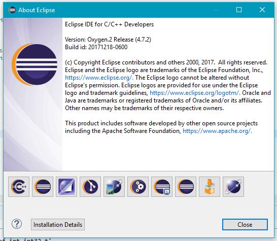

Software: (ATTACHED PICTURES)
> Eclipse C/C++ (Oxygen.2 Release (4.7.2) - Build id: 20171218-0600)
> MinGW (latest version)
> Boost 1.66.0 (C:\Program Files\boost\boost_1_66_0)
> MySQL Connector C++ 1.1.9 64b
> Windows 10 64b

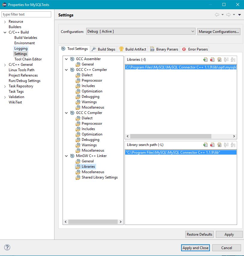

Eclipse Config: (ATTACHED PICTURES)
C++ Build >> Settings >> GCC C++ Compiler >> Includes >> Include paths (-l):
"C:\Program Files\MySQL\MySQL Connector C++ 1.1.9\include"
"C:\Program Files\boost\boost_1_66_0"
C++ Build >> Settings >> MinGW C++ Linker >> Libraries >> Libraies (-l):
"C:\Program Files\MySQL\MySQL Connector C++ 1.1.9\lib\opt\mysqlcppconn-static.lib"
"C:\Program Files\MySQL\MySQL Connector C++ 1.1.9\lib"

Re: Can't use MySQL Connector to deploy a C++ program [message #1783309 is a reply to message #1783087] Sun, 11 March 2018 11:20 Go to previous message
Hi ,
It has nothing to do with Eclipse CDT.
From the warnings (e.g. warning: ignoring #pragma warning [-Wunknown-pragmas]... "#pragma warning (disable : 4290)" and more pragma warnings ) and the error (error: conflicting declaration 'typedef long int int32_t'
typedef __int32 int32_t;) I deduce that the library you are using a MS Visual C++ library. But you are using MinGW (g++) .
In general you cannot use the C++-library compiled/linked with one compiler for the compilation/linking with another compiler. SO find a MinGW (g++) library for MySQL or use a plain C ODBC-type library.
Joost
