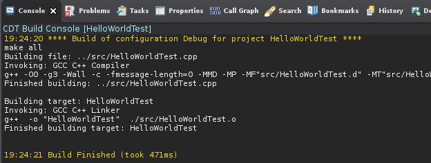

Looks like this
index.php/fa/32263/0/
Note that is starts "CDT Build Console".
If you don't see one, do Window --> Show View --> Console
There is also a Global Build Console selectable from a pull-down menu in the Console View.

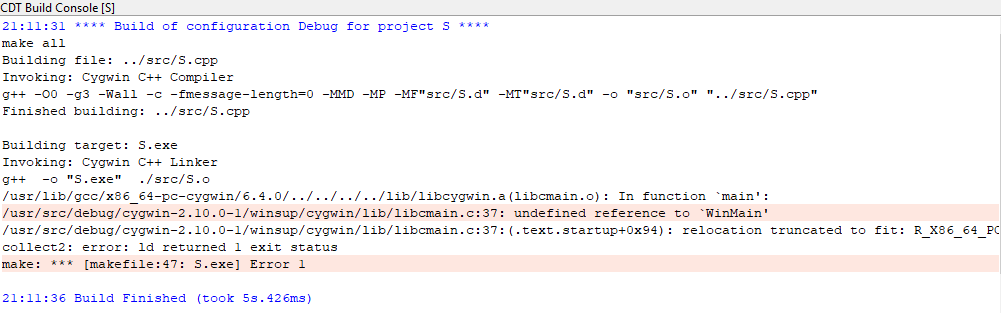

I built the project alone in a new workspsace. this happened. compiler error?

Not a compilerr error. Your projet is misconfigured.
Read this on one way to resolve it:
https://www.eclipse.org/forums/index.php?t=msg&th=1092012&goto=1782973&#msg_1782973
Specifically,
    Create an HelloWorld project (with a different name);
    Delete the HelloWorld.cpp (which actually is <project name>.cpp);
    Copy your source into the src directory;
    Select a build configuration;
    Then build it.
You edited your post to say something about running your original project.
You posted an image of a build log that showed an incremental build was unnecessary.
I think you clicked "Run" and it ran a different project.
If so, you need to set up a launch configuration for your program.
