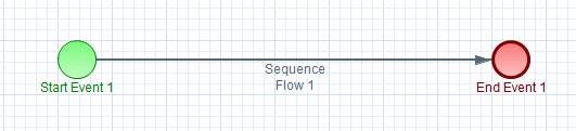

I created a simple bpmn model using the bpmn2-modeler plugin, here is the model (I removed the Diagram part to make it simpler):

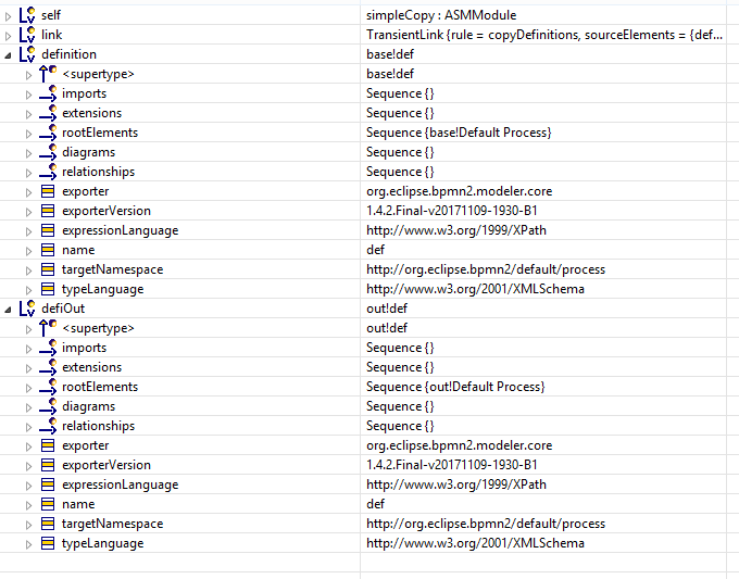

I debug the rule "copyDefinitions" and I see it is copying elements correctly (see debug uploadad image).
Here is my transformation, I'd appreciate help to realize what I'm doing wrong.

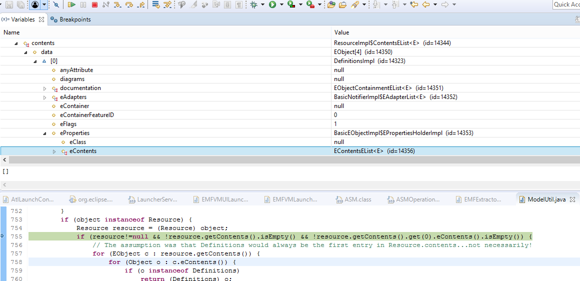

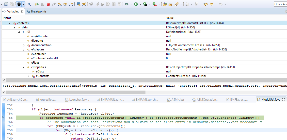

I downloaded the source code and started debugging.
The NullPointerException is because the ModelUtil.getDefinitions method (org.eclipse.bpmn2.modeler.core.utils.ModelUtil) gets info from eContents and it is empty (attached image "eContents").
However, in the same breakpoint I can see that "contents" has the info (attached image "contents")
Is this because of something I'm doing wrong or the model creation never sets that field (eContents)?
Any ideas to make it work?
