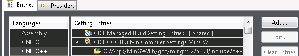

The settings for Project --> Properties --> C/C++ General --> Preprocessor Include Paths, Macros etc. are defined by language.
So are the settings for Paths and Symbols
In Project --> Properties --> C/C++ General --> Preprocessor Include Paths, Macros etc.
Define a User Entry for C++ as __cplusplus (Note the double underscore)
The compiler should also set this and it should appear among the entries for the built-ins.
Maybe your compiler built-ins provider doesn't have it (e.g., Visual C/C++ doesn't have a way to list bult-ins)
Setting it as a User Entry should fix that.
Alternately, defining it in Paths and Symbols should work too.

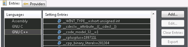

MinGW GCC Built-ins
Note that __cplusplus is defined as 199711L by MinGW GCC

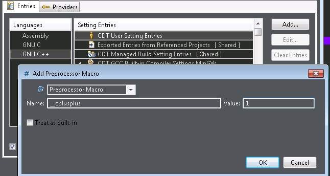

Adding a macro definition
index.php/fa/32203/0/
Be sure to select the proper configuration name when you do this.
