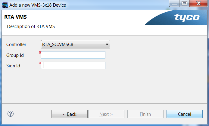

The replay process does not work properly at (please check the attached picture):
get-editbox -after [get-label "Group Id"] | set-text 1
get-editbox -after [get-label "Sign Id"] | set-text 1
There is no errors from the console.log or .log for this issue.

According to your problem, try to replace
with
get-editbox -index 0 | set-text 1
get-editbox -index 1 | set-text 1
Will it work?

I just checked your advice. Unfortunately, I am not lucky. It is not working.
I have got the rcptt code and make it running in my computer. Could you possibly let me know which project or package (tesla or ecl.core) I can trace when this issue happen?

Re: Some text fields cannot be filled when replaying [message #1783342 is a reply to message #1782684] Mon, 12 March 2018 04:59 Go to previous message
If you execute tests with RCPTT IDE, check execution details after the test fails (click 'Details...' button in 'Execution View')
The detailed info contains 'swt.info' section, it should help you to understand what controls RCPTT is able to verify
Check if it contains info about the test fields and verify if their labels are correct
