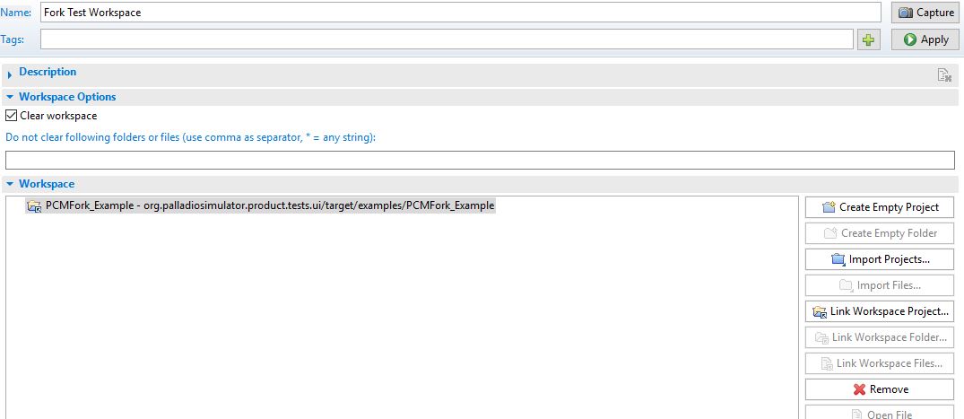

Re: Name of a Linked Workspace Project in Context [message #1782640 is a reply to message #1782618] Tue, 27 February 2018 05:22 Go to previous messageGo to next message
Hi Viktoria,
thanks for your answer :)
I create a new workspace context and add the project folder via "link workspace project".
after that, the project will appear there with the folder name (PCMFork_Example) instead of the name of the project it contains (PCMForkExample).
if I add the project via the "import project" function, the project has the correct name "PCMForkExample", but i need the modified files downloaded from my maven script.
the .project file is placed directly in the folder and looks like this:

  • Attachment: Unbenannt.JPG
