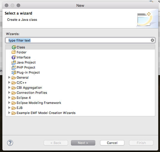

Re: Unable to install local updates [message #1782468 is a reply to message #1782460] Fri, 23 February 2018 13:15 Go to previous messageGo to next message
Which new wizard?
index.php/fa/32172/0/
Do you mean File > Import > Existing projects into workspace?
Sorry but please be more explicit about the steps you're doing. I can't make sense of what you're describing. ¯\_(ツ)_/¯
