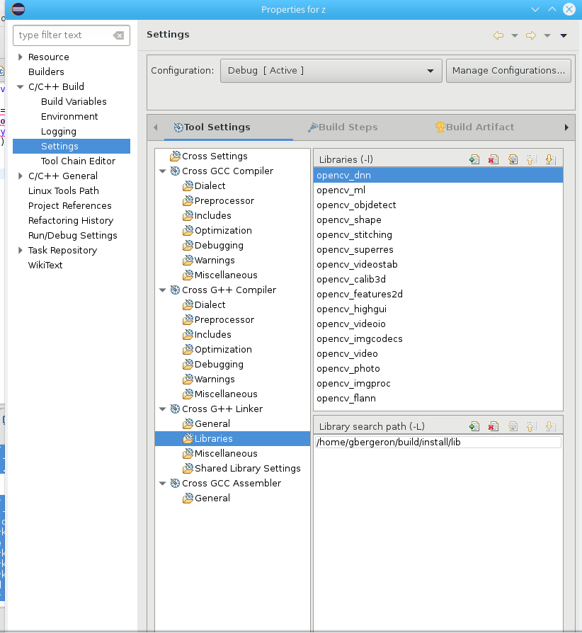

I have linked the required libraries in the setting (cross g++ linker) but it just won't work.
