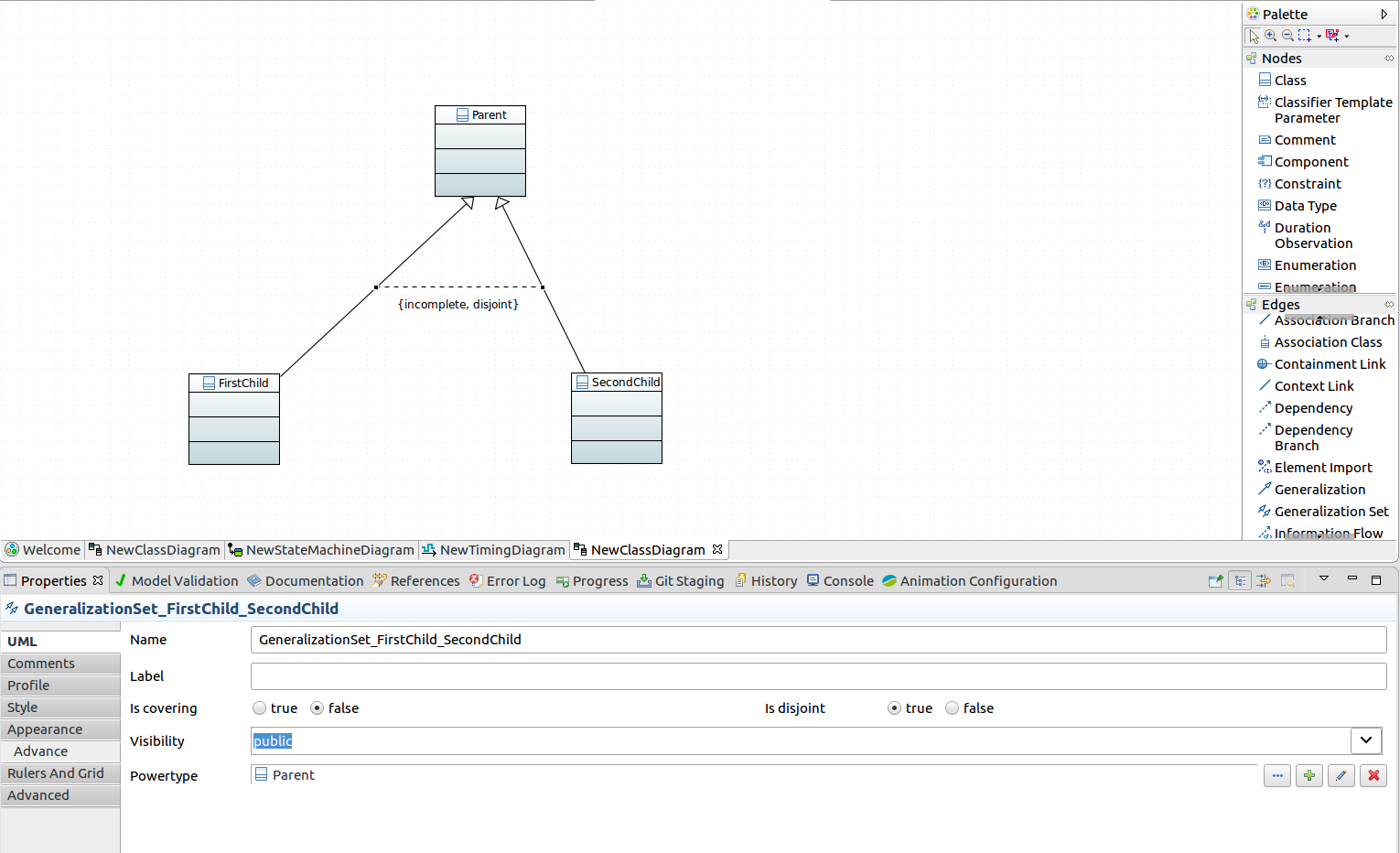

Re: Generalization problem [message #1782072 is a reply to message #1782031] Fri, 16 February 2018 13:21 Go to previous messageGo to next message
Hi Eduardo,
sorry I overread you asked for step by step instruction.
OK, here it is:
Accordung to the OMG UML 2.5.x specification chapter 9.9.8 "GeneralizationSet [Class]" subclause 5 a GeneralizationSet owns Generalization associations as assciation ends. As Papyrus strictly adheres to the OMG UML 2.5.x specification this gives you a hint how to specify a GeneralizationSet.
As a GeneralizationSet refers to Generalization associations, you simply pick the Generalization associations out of the palette and draw a virtual line starting at the first Generalization association and ends at the second Generalization association.
This results in
index.php/fa/32114/0/

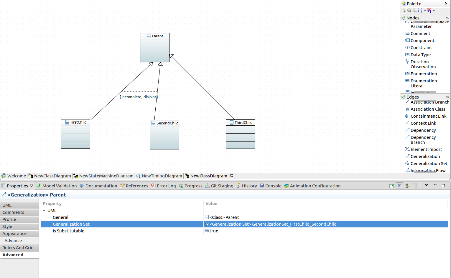

To add further Generalization associations to the GeneralizationSet is a little more tricky.
index.php/fa/32116/0/
As you see in the screen shot above a GeneralizationSet has a properties view, the properties view itself has an "Advanced" tab. Wtithin the advanced tab a attribute "Generalization Set" exists. At the right side end of the "Generalization Set" attribute line you'll see three dots, click on these three dots to select the GeneralizationSet the Generalization should be added to.
That's all.

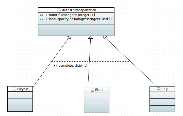

Re: Generalization problem [message #1782102 is a reply to message #1782037] Sat, 17 February 2018 11:30 Go to previous messageGo to next message
Hi Ed,
I interpret
index.php/fa/32119/0/
that way.
1. The GeneralizationSet is incomplete, it does not meet the Liskov criteria.
2. The GeneralizationSet is disjoint, an instance of the classes within the GeneralizationSet may not be also an instance of another class within by the GeneralizationSet (e.g. an instance of MeansOfTransportation may not be a Bicycle and also a Plane)
Well, a sane model shall ensure
1. the Liskov criteria is always met
2. classes are disjoint
As a result I regard the GeneralizationSet as a means to indicate technical debt ;-)
/pica

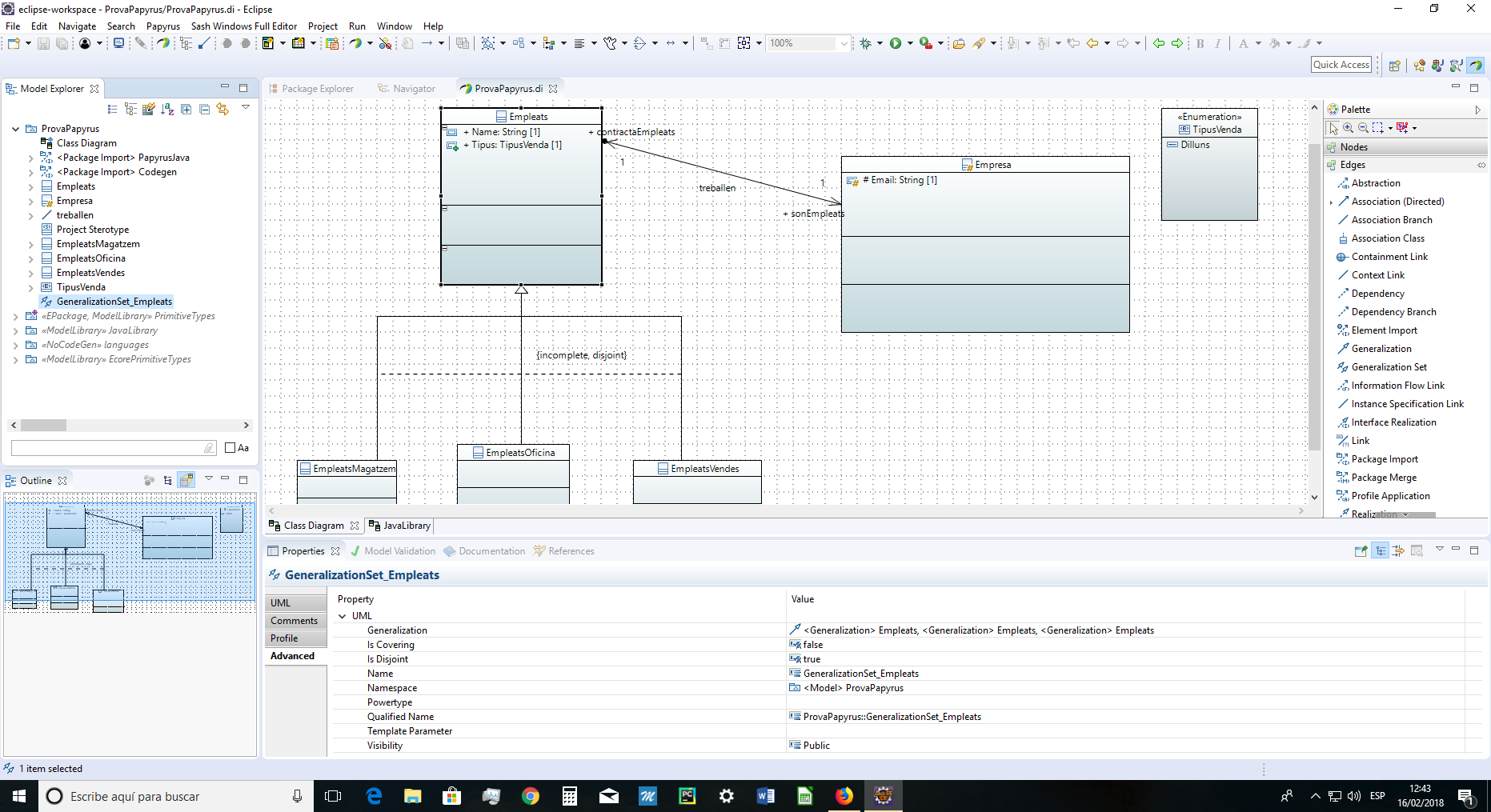

Re: Generalization problem [message #1782128 is a reply to message #1782031] Mon, 19 February 2018 05:30 Go to previous messageGo to next message
Thanks for your help.
Im interested in payment methods are disjoint and complete ( for example credit card, paypal, or cash).
After touching and some try and error... I have made a similar case. Using employees ( empleats) from a company. So the company has different kinds or classification ( sales employees, computer employees, marketing employees....). So i set manually the GeneralizationSet as a three-member set which the same name ( GeneralizationSetEmpleat). And three childs: EmpleatOficina, EmpleatMagatzem and EmpleatVendes. I think its ok.... as /Carsten suggested using the advanced tab in a GeneralizationSet ....
index.php/fa/32129/0/
[Updated on: Mon, 19 February 2018 05:38] by Moderator
