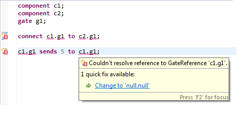

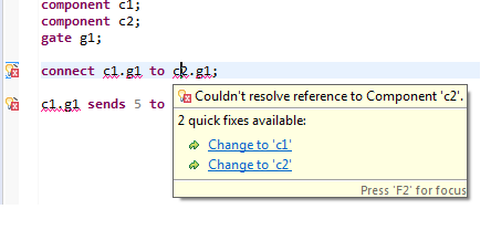

In the textual connection specification, it finds and underlines errors in above, but suggests exactly those same names as quick fixes. See attached images for more information.
To fix the problem, I would like to reference a GateReference in an Interaction with the following name : componentName.gateName

there are no runtime error, but the code still doesn't seem to accept the gateReference's name when used in an interaction.
component c1;
component c2;
gate g1;
connect c1.g1 to c2.g1;
c1.g1 sends 5 to c2.g1; //says that it couldn't resolve reference to both GateReference c1.g1 and c2.g1
I used the same scoping class as the poster's one.
Is there something I'm missing?
Re: implementing QualifiedNameProvider [message #1782399 is a reply to message #1782021] Thu, 22 February 2018 11:47 Go to previous messageGo to next message
Hi Christian,
I'm actually having a very similar problem right now. I implemented the poster's original code and tried adding your suggestions, namely in the qualifedNameProvider
package org.xtext.example.mydsl2.scoping;
import org.eclipse.xtext.naming.DefaultDeclarativeQualifiedNameProvider;
import org.eclipse.xtext.naming.QualifiedName;
import org.eclipse.xtext.nodemodel.util.NodeModelUtils;
import org.xtext.example.mydsl2.myDsl.GateReference;
public class MyQNProvider extends  DefaultDeclarativeQualifiedNameProvider {
	protected QualifiedName qualifiedName(GateReference gateReference) {
		String gateReferenceText = NodeModelUtils.getNode(gateReference).getText().trim();
		return QualifiedName.create(gateReferenceText);
component c1;
component c2;
gate g1;

Re: implementing QualifiedNameProvider [message #1782405 is a reply to message #1782401] Thu, 22 February 2018 12:42 Go to previous message
the segements you call QualifiedNAme.create(segment1,...,segementn) may not contain "."
String gateReferenceText1 = NodeModelUtils.findNodesForFeature(gateReference, MyDslPackage.Literals.GATE_REFERENCE__COMPONENT).get(0).getText().trim();
String gateReferenceText2 = NodeModelUtils.findNodesForFeature(gateReference, MyDslPackage.Literals.GATE_REFERENCE__GATE).get(0).getText().trim();
return QualifiedName.create(gateReferenceText1,gateReferenceText2);
or
return getConverter().toQualifiedName(gateReferenceText);
