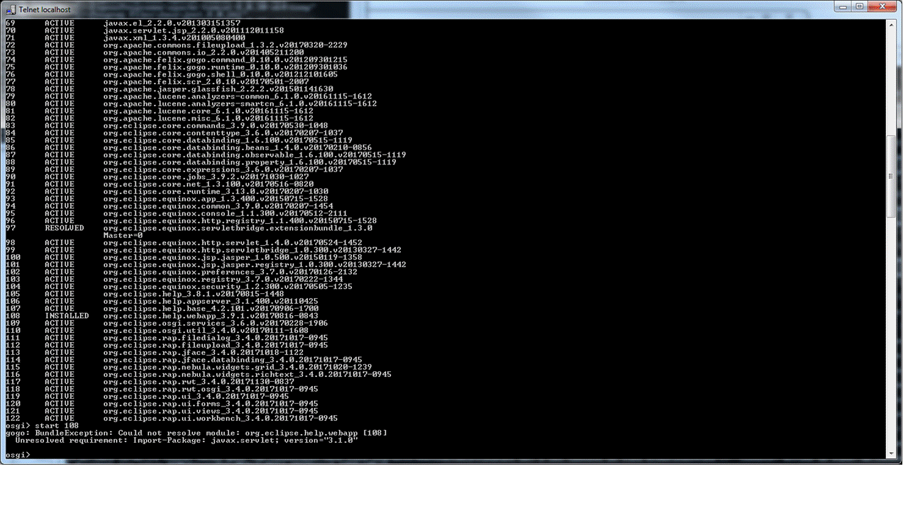

Hi all,
unfortunately, I still have a problem with running the help system in my rap application. The help system works fine, when I start the rap application from the eclipse development environment. However, if I deploy the application under tomcat, the help system won't start.
If I connect the osgi console to the tomcat web-app, I can see that the org.eclipse.help.webapp is installed (see screen shot). If I, however, try to start the bundle, it complains that javax.servlet cannot be resolved.
index.php/fa/32313/0/
However, the bundle should not be added according to the rap documentation.
Has somebody an idea, how I could solve this problem?
Thanks in advance,
Sebastian
Re: Help System under 3.4 [message #1783588 is a reply to message #1783507] Wed, 14 March 2018 08:22 Go to previous message
Hi all,
I found a way to solve the problem. I had to modify the Manifest.mf in the org.eclipse.help.webapp_3.9.1.v20170816-0843.jar bundle.
In the manifest there was the following import requirement:
Import-Package: com.ibm.icu.text;version="3.8.0",javax.servlet;version
="3.1.0",javax.servlet.http;version="3.1.0",org.osgi.service.http;ver
sion="1.2.0"
I removed the dependency from javax.servlet und javax.servlet.http from the manifest. Then the help system could be used again.
Sebastian
