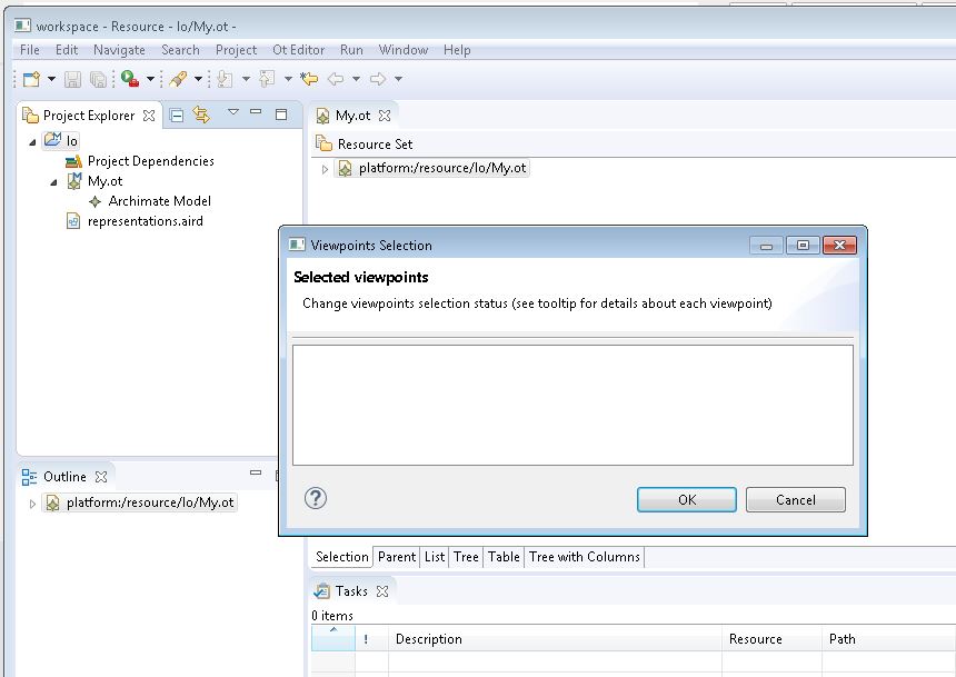

I create my RCP sirius product with Maven following this tutorial: https://www.youtube.com/watch?v=ZmUrTlzqCXc
Everything was fine until I try to add a viewpoint specification to the modeling project I create.
The model works but the viewpoint selection dialog looks empty.
My odesign file works fine when I test it.
My featuyre project imports all projects required (model, edit, design..) My ot.parent folder includes the design project.
I am using eclipse Neon.3 Release (4.6.3)
Sirius 6.0
Maven 1.7
Any clue why this is happening?
index.php/fa/32035/0/
Thank you so much!!
Lina
  • Attachment: Captura.JPG
    (Size: 70.28KB, Downloaded 986 times)

Hi Lina,
Could you check the Model File Extension property of your Viewpoints : it defines the kind of models associated to the designer. We encourage you to set the extension associated to your domain model, from your screenshot it seems you should put ot or *.
Could you also check the activator of your viewpoint specification project (design), in the start method, check the line with "viewpoints.addAll(ViewpointRegistry.getInstance().registerFromPlugin(PLUGIN_ID + "/description/yourVSMName.odesign")); "
The path and odesign name has been generated by the new Viewpoint Specification Project, but if you renamed the design file later, the registration of the VSM in the activator might be invalid now.
Re: No viewpoints on sirius rcp product [message #1781784 is a reply to message #1781587] Tue, 13 February 2018 05:23 Go to previous messageGo to next message
Hi Lina,
The path and odesign name have been generated by the new Viewpoint Specification Project, but if you renamed the design file later, the registration of the VSM in the activator might be invalid now.

Hi Maxime,
Thanks for answer. My mistake was the sirius version. I create my odesign file with version 6.0. But when I create the product a 4.0 Sirius version was installed, so I add this to my pom properties in case anyone need it.
<sirius-repo.url>http://download.eclipse.org/sirius/updates/nightly/latest/oxygen</sirius-repo.url>
Lina.
Re: No viewpoints on sirius rcp product [message #1782502 is a reply to message #1781783] Sat, 24 February 2018 17:47 Go to previous message
I was facing the same issue. A mismatch between Model File Extension and the actual file extension of the test model.
Thanks Maxime,
Martijn.
