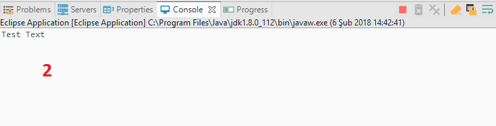

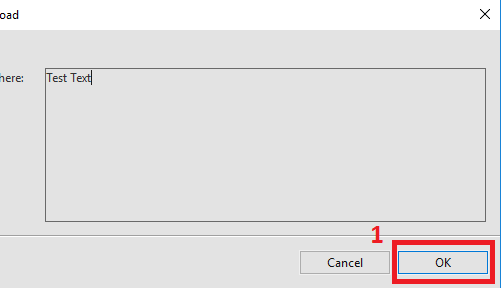

I would like to know how to get value of the Widget/TextArea which comes in a Dialog when a tool is used. Basically, I want to print out that value in console with System.out.println(value) where I call it from a custom Service when "OK" button is pressed.
All I want to do is this;
index.php/fa/32017/0/
index.php/fa/32018/0/
