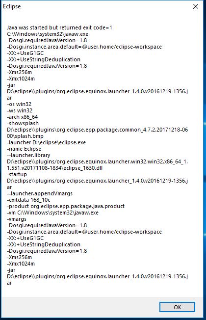

Whenever I try to launch Eclipse 'JVM Launcher' error and the Images attached
Please find the screenshots and help me out

Re: Java Virtual machine error [message #1781476 is a reply to message #1781321] Wed, 07 February 2018 12:11 Go to previous messageGo to next message
It sounds like you have a bit-ness mismatch: it looks like you're trying to run a 64-bit version of Eclipse, but you have a 32-bit JRE/JDK.
https://wiki.eclipse.org/Eclipse/Installation#Troubleshooting
Re: Java Virtual machine error [message #1804243 is a reply to message #1781476] Thu, 21 March 2019 02:48 Go to previous message
There is not enough virtual memory space requested by an application thus the application fails to start. This usually happens during the application startup phase. Applications reserve a large amount of virtual memory for the JVM heap space during the startup phase. Java on Windows uses an initial size of 16 Megabyte and a maximum of 64 Megabyte.
Most of the time you can fix this problem by uninstalling the Java runtime and then reinstalling it all over again. You can also try increasing the amount of system memory allocated to the Java virtual machine by setting an environment variable.
