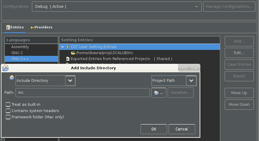

You haven't shown the User Entries you are using.
It should at least have "linux-bmc/include"
Using paths relative to the project or workspace are OK but
I recommend defining then while using the drop down menu in the upper right of the "Add" dialog.
index.php/fa/32022/0/

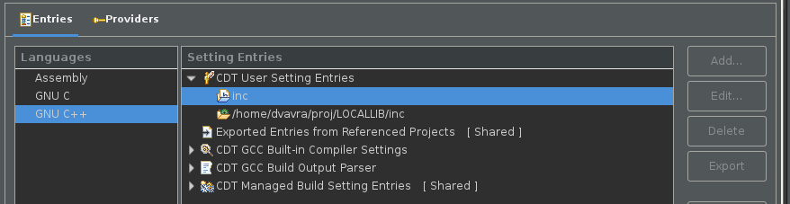

FYI: The displayed user entry for LOCALLIB/inc is a different directory than ${project}/inc that I have selected.

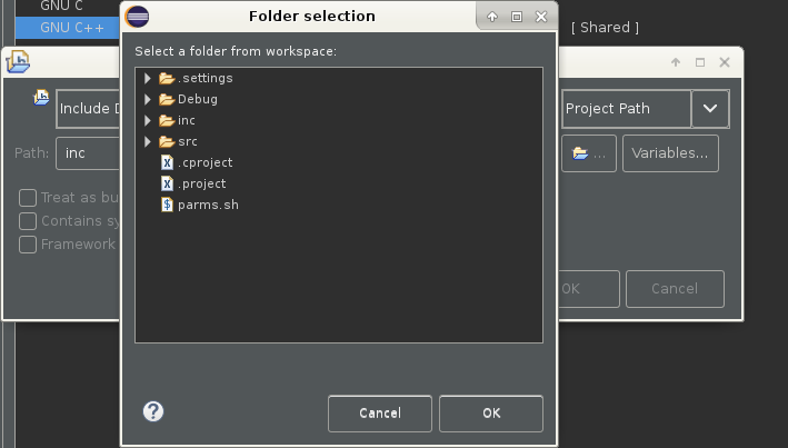

Pushing the folders button shows the folders relative to the current project.
index.php/fa/32024/0/
Here's the result
index.php/fa/32027/0/

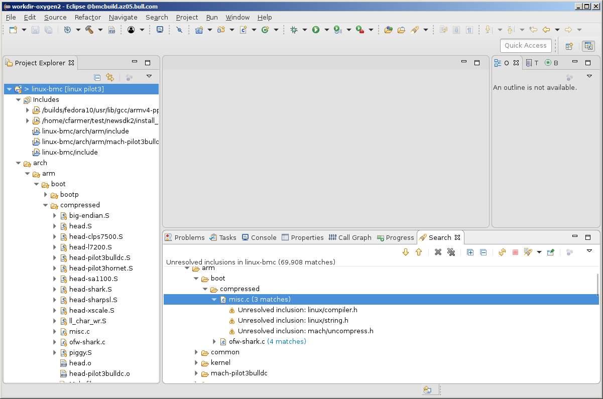

Thanks for reading my message and replying. [I should have added my image to the body, rather than only as an attachment.] With respect to the original attachement, the Project Explorer pane "Includes" items are include directories in the configuration (this is different from the directory "includes").
In the Project Explorer pane, it is odd that include directories entered as "file system path" show subordinate directories and include files, but include directories within the Project do not show any subordinate detail. Its been a few days, but I believe it doesn't matter how the include directory is entered. CDT recognizes the path as being inside the project and doesn't show any detail.
Back to the problem
I don't understand why the indexer is not finding include files that are in configured include directories.
I deleted the project and created it again, this time specifying toolchain <none>. I un-selected the two other Providers, leaving only "CDT User Setting Entries". As before, I added all the include files, include directories, preprocessor macros, etc. When I clicked "Close and Apply", the indexer ran. After it finished, I noticed that I had forgotten to set source filters to eliminate non-arm architecture files under ./arch, ./arch/mach-<other>, and ./include/asm-<other>. I set the filters and the indexer ran (after sending an error report). In any case, Index -> Rebuild did not report another error.
I did project Index -> Search for unresolved includes. The results follow.
index.php/fa/32038/0/

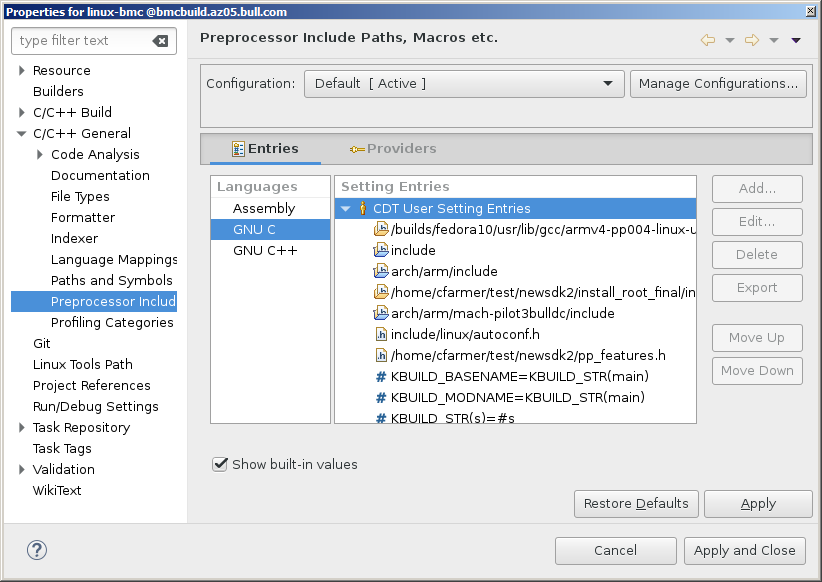

And before anyone asks, I do have the User Entries setup.
index.php/fa/32037/0/

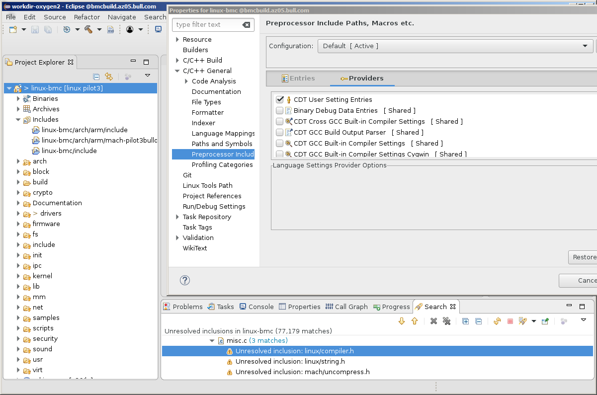

I'm not sure if it is related, but I should mention that I'm not building with Eclipse. The actual build process is script driven and runs in a container that can't host a current Eclipse.

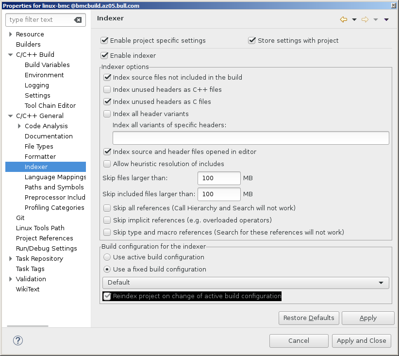

Following are my current Index Settings. Some Eclipse documentation suggests choosing between Fast and Full indexers. I don't see any way to do that.
index.php/fa/32041/0/

Again, thank you for helping. I don't understand what some of the Indexer options actually do, so I might have a setting that is preventing the result I want.
I have specified Indexer options:
    Set Project Specific Settings
    Set Store Settings with Project, Enable Indexer
    Set Index source files not included in the build (Since I'm not building with Eclipse, I assume it doesn't know which files are included. If it is looking for existing ".o" files, I can could set this.)
    Set Index unused headers are C files
    Not set index all header variants (I don't know what it does, but setting it does not help my problem.)
    Set Index source and header files opened in editor (I don't now if this matters.)
    Not set Allow heuristic resolution of includes (seems enable less-than-correct parsing in the name of speed.)
    Set skip files larger than to 100 MB (I don't want to skip files.)
    Not set any of of the "Skip" options.
    Set Use a fixed build configuration (Not sure what active does.)
I need for CDT to follow the C preprocessor rules as it is parsing each source file. I'm willing to let the parser run for hours if it will produce results that match the actual build. The Fast/Full option seems to have disappeared. Is Full now the default?
I disabled The GCC Build Output Parser, because I wasn't sure what it did with Linux. Since I've done a Linux build, there is a <module>.o file (ELF with debug) and a .<module>.o.cmd file (gcc command line with -D, -I, -include, etc.) for every module built. My guess was the BOP wanted to run build (make) commands to see the output. Is there a BOP that looks at existing .o and .cmd files to guide the parser?
I'm not sure what you mean by " the cache can have only one value and the value may depend on the reading order". For any line of source (including #if statements) a macro is either undefined or has one value.

You can try playing with the Indexer options but I don't think you can turn off caching.
If you have macros with multiple values (say configuration macros) you can try forcing them as I mentioned above.
There is a way to specify that the active configuration would be used. Not sure if that means there are multiple indices.
Another option might be to keep multiple configurations in separate projects.

Here's my 2 cents! :)
I administer our Eclipse Program configurations which may include several projects. I'm continually refining our configurations based on user feedback.
I have found that Eclipse does a very good job at parsing source (.c/.h) source files for symbol information.
We use Eclipse for editing, static code analysis (codan), syntax highlighting, custom code style formatter, custom code templates and building.
Our build is script driven; we don't build with any Eclipse support tool chains. But to get the indexer support, a supported toolchain needs to be selected. Getting the indexer to behave the way we require, took many hours of trail & error. Including many 'start overs' (starting a workspace & project from scratch).
So I've included screen captures about creating a 'C' project (externally built) and indexer configuration. Hopefully, it helps. The one negative about Eclipse CDT is that sometimes there are interactions which are obscure. ;(
We build C programs for embedded platforms on Windows 7.
Tim
