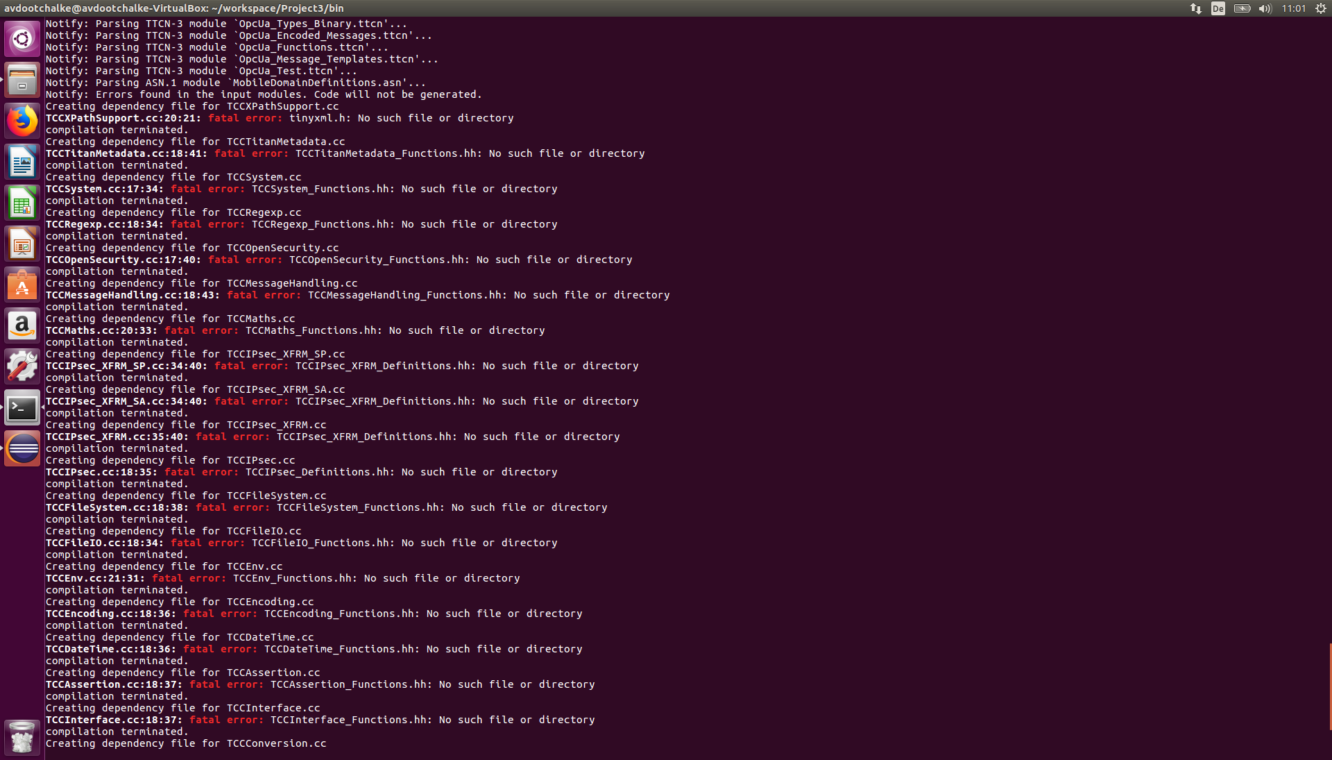

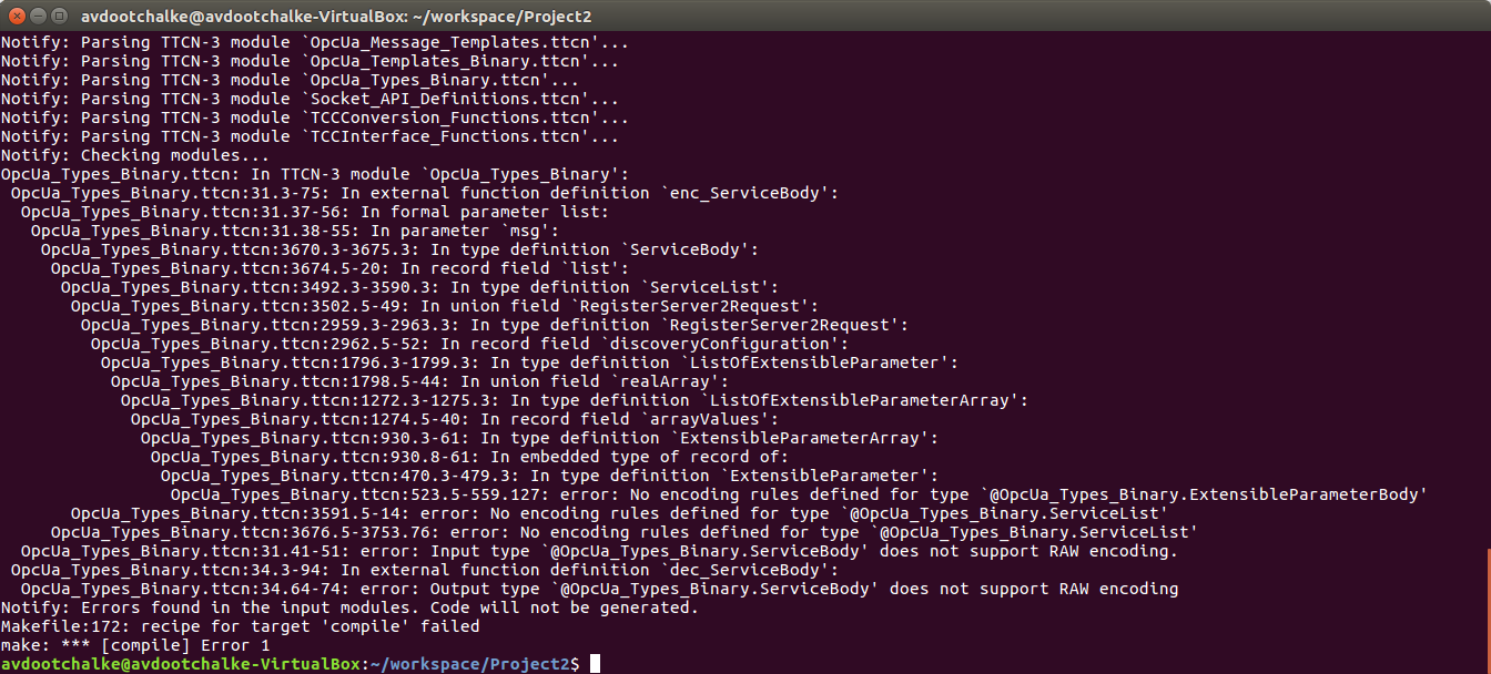

I got a compilation error while running the opc-ua project. The error states that 'no encoding rules have been defined for a parameter in a module'. Can someone tell me where am I going wrong?
Attached is the screen shot of the compilation error.
Any advice is highly appreciated! Thanking You in Advance!

Hi Avdoot,
you need to add -e to the Makefile , compiler flags:
# Flags for the TTCN-3 and ASN.1 compiler:
COMPILER_FLAGS = -L -e
For the whys , see here:
Heads up on the upcoming release of Titan version 6.3.0
https://www.eclipse.org/forums/index.php/t/1090378/
We'll try to make this clear in the documentation.
Please be aware that this is not a fully functional, finished product , it's work in progress.
BR
Elemer

Re: OPC-UA Module compilation Error [message #1781271 is a reply to message #1781266] Mon, 05 February 2018 06:23 Go to previous messageGo to next message
Hi Avdoot,
your project apparently has unmet dependencies ; as far as I can see they are from https://github.com/eclipse/titan.Libraries.TCCUsefulFunctions
but there might be others.
please download them and add them to your project.
In order for the compiler to find them, appropriate modifications have to be done in the Makefile.
BR
Elemer
