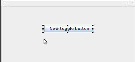

Using WindowBuilder to try and make a simple Swing window with a button on it, I'm unable to move to resize said button in the designer.
The resize dots appear in the designer, and I can drag them which shows coordinates like it normally would, but when I release the mouse button, the buttons size remains unmodified.
Same thing happens when attempting to just move the button instead. I can place a new button anywhere I want in the designer, but I can't move it once I've placed it, though the UI otherwise responds appropriately.
I'm only attempting to use a button for a example. This seems to happen with all UI elements I've tried so far.
I'm using the Absolute layout. Code, gif showing example, and versions below;
Halp

Attachment: Test.gif
(Size: 87.22KB, Downloaded 18334 times)

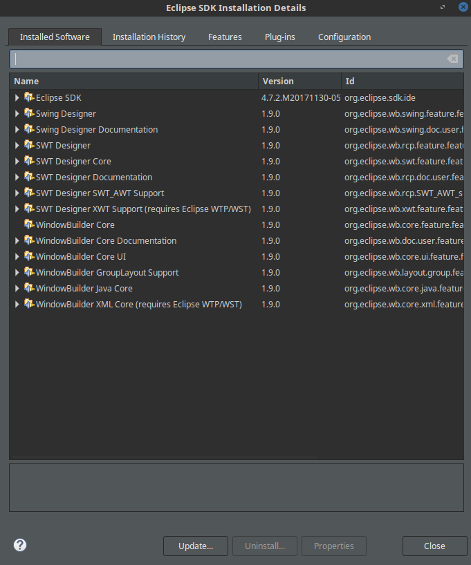

Attachment: S2lcC4X.png
(Size: 92.30KB, Downloaded 17821 times)

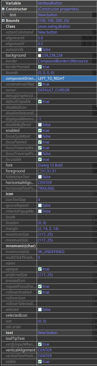

It was set to 'UNKNOWN' by default. I've attempted to change it to LEFT_TO_RIGHT, and RIGHT_TO_LEFT to no effect on the designer.
Below is the source again, in case anything changed, and a picture of the properties menu of the button. All values are set to default, besides coords/size and orientation, which I left at LEFT_TO_RIGHT.
Stuff

Attachment: btnprop.png
(Size: 98.95KB, Downloaded 17512 times)
