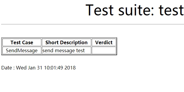

from userguide.pdf ,I know repgen can generate test reports(*.html) according .log file, and the *html contains two list boxes and four buttons,so I write a .ts file ,and perform repgen *.ts ,*html is created,
but the page content is too less ,can't meet my need,I want to it can display more information about testcase .

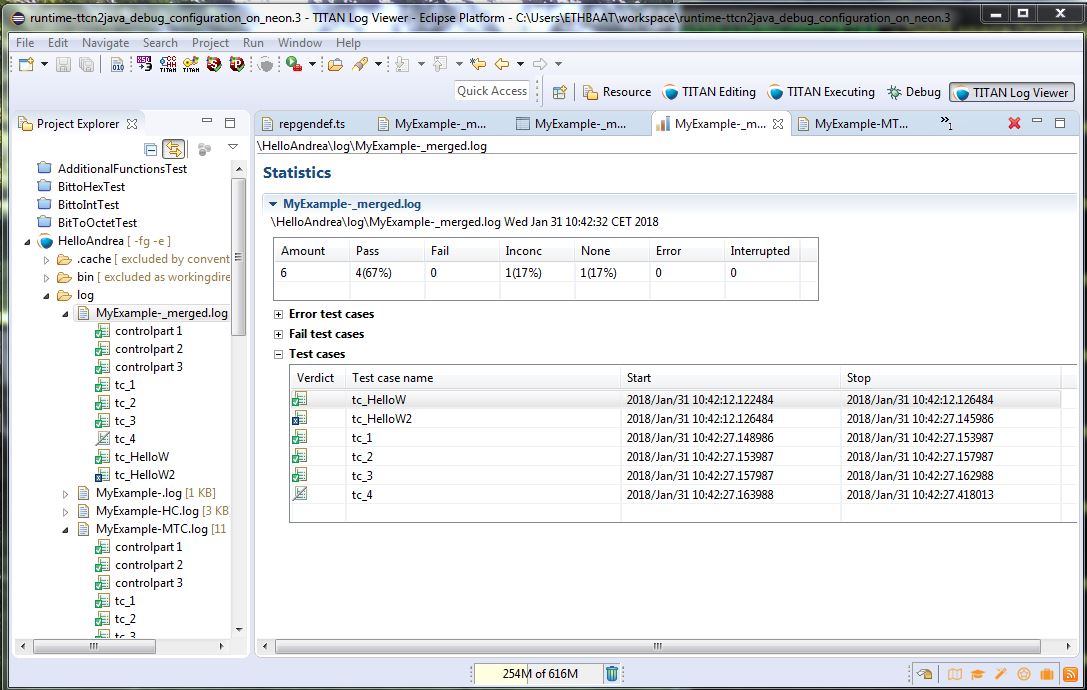

Sorry for the late answer but repgen is absolutely out of focus and I should have tested all the functionality to answer. The titan.EclipsePlug-ins (our ttcn-3 IDE) contains a LogViewer with a more sophisticated service (see Capture5.JPG)
index.php/fa/31974/0/

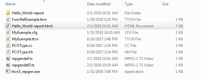

The file Hello_world-report.html and a subdirectory are created ( See CAPTURE1.PNG)

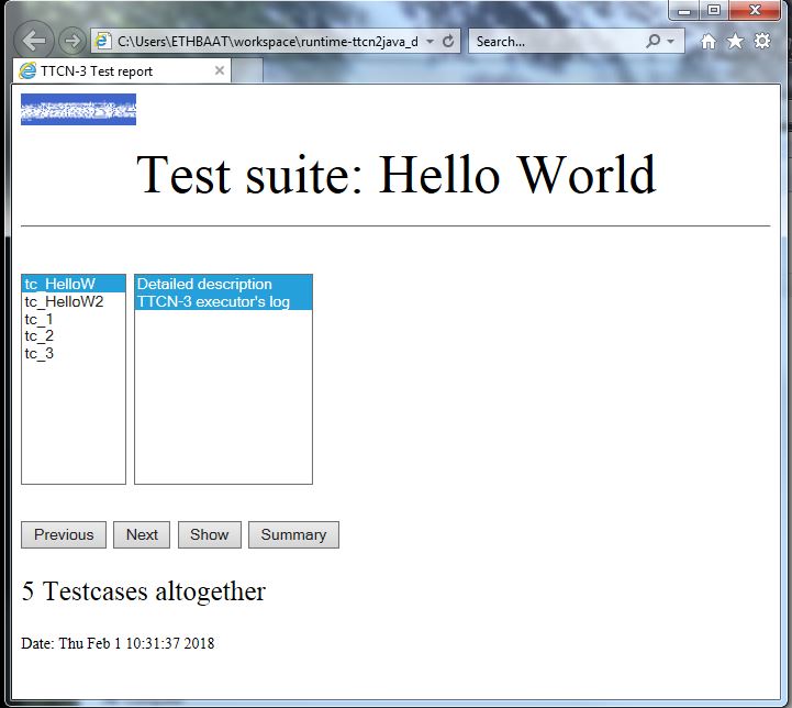

4. Open the main report page "Hello_World-report.html" with a browser! The result will depend on the browser and its settings. In case of Windows Explorer the result can be seen on Capture2.JPG (if ActiveX is enabled and blocked content is allowed).
index.php/fa/31970/0/

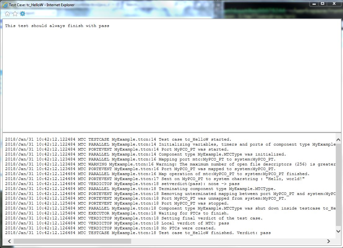

4. Select a testcase with the Next or Previous buttons and push the button Show.
A page of the testcase will be opened with information of description and of the logging of that testcase. (Capture3.JPG)
index.php/fa/31971/0/

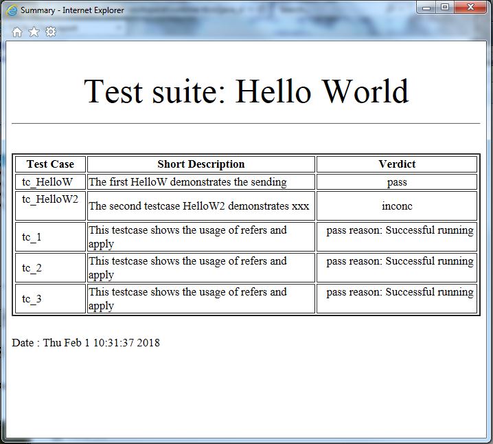

5. Go back to the main page and push the button "Summary". A page with the list of the testcases will appear. The columns of the table are Test Case, Short Description, Verdict (Capture4.JPG)
index.php/fa/31973/0/

Logs can be presented in three views,Respectively,Statistical View,MSC View and Text Table View.
