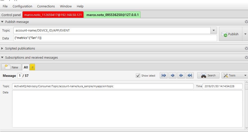

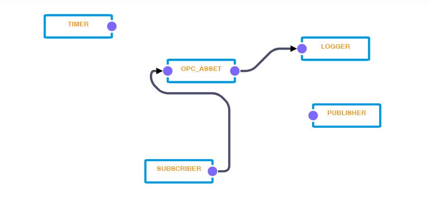

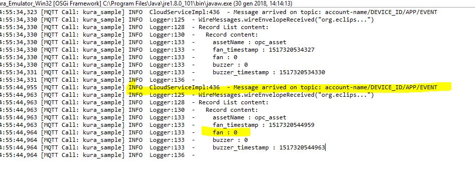

Good morning. I'm using opc/ua server simulator from https://eclipse.github.io/kura/wires/kura-wires-opcua.html.
I'm trying to write a value in the fan variable, but it doesn't seem to work. I use a subscriber linked to the asset and i send a json message like {"metrics":{"fan":1}}, please see image.
Does the demo server support writing?
Thanks in advance
marco.

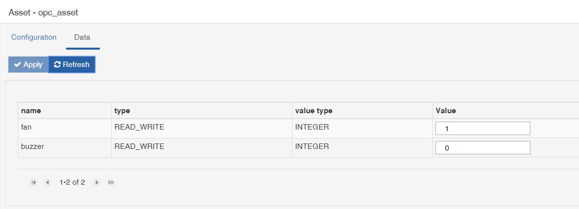

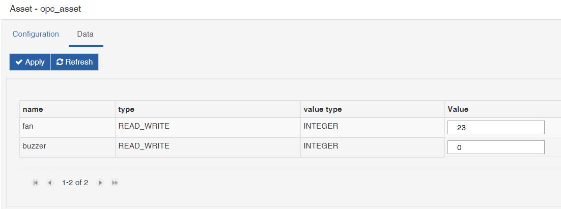

Re: OPC DEMO - write variable [message #1781160 is a reply to message #1781052] Fri, 02 February 2018 03:29 Go to previous messageGo to next message
In the data table works partially, in the sense that any value I enter, the result is to obtain 1, see screenshot please.
Re: OPC DEMO - write variable [message #1781161 is a reply to message #1781160] Fri, 02 February 2018 03:33 Go to previous messageGo to next message
for what I remember of that demo, those channels are booleans.
Matteo

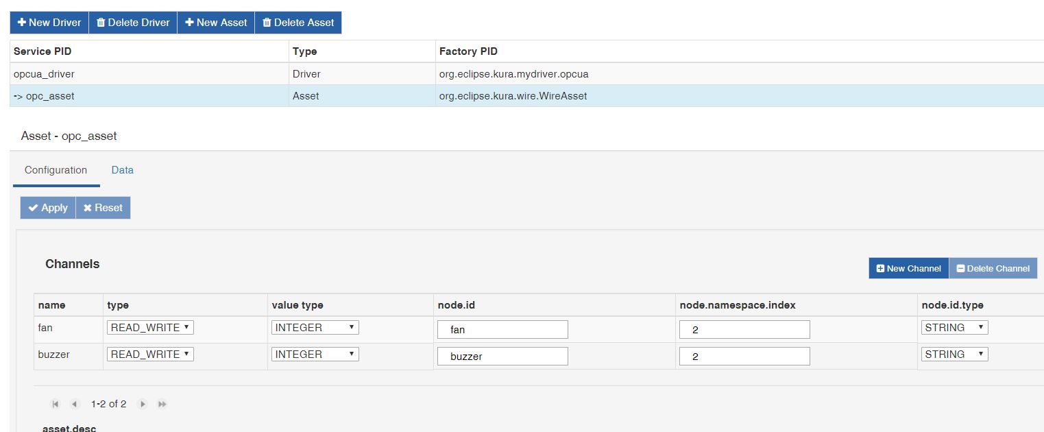

Re: OPC DEMO - write variable [message #1781178 is a reply to message #1781161] Fri, 02 February 2018 05:24 Go to previous messageGo to next message
I follow the https://eclipse.github.io/kura/wires/kura-wires-opcua.html documentation:
https://eclipse.github.io/kura/assets/images/wires/OPCUADriverConfig.png
