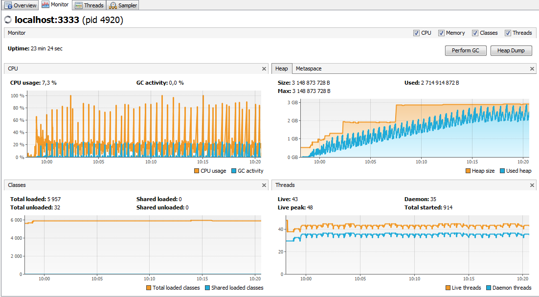

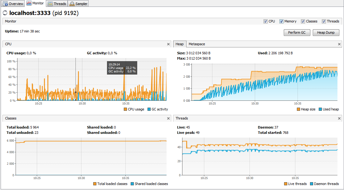

Thanks for the information about the plugin versions. I will modify the code that I have done to follow these rules.
Regarding the consumption of the memory, I have tested using the GC command.
I add the result screenshots: with and without the GC command.
For me, it seems that some elements remain in memory even after each deactivation. Do you have any idea ?
Thanks.

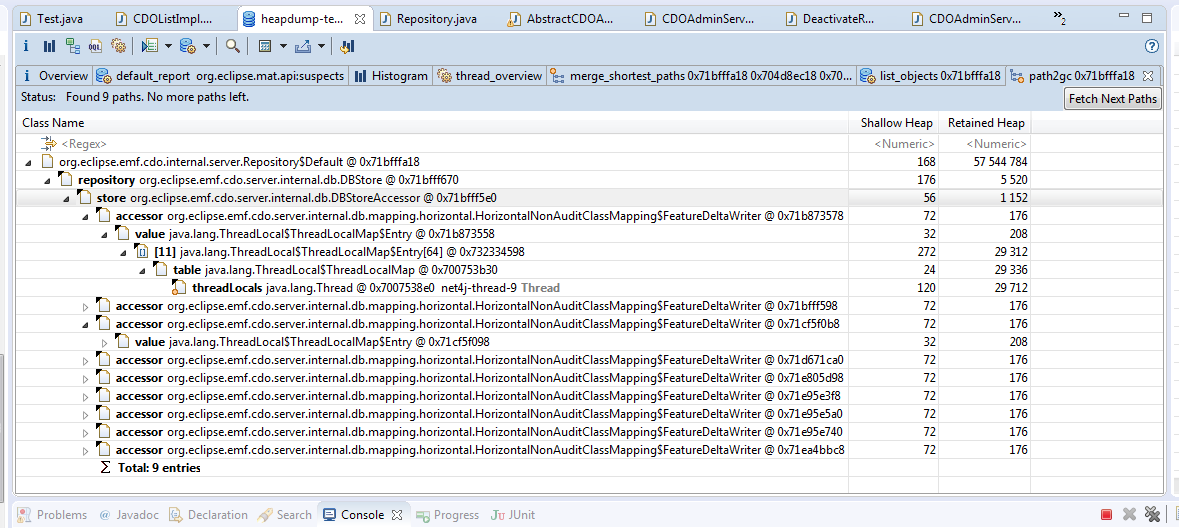

Re: [CDO] Way to open and close repository thanks to an admin repository [message #1783164 is a reply to message #1782132] Thu, 08 March 2018 11:03 Go to previous messageGo to next message
I have done a memory snapshot as you said. I think I may have a lead on the reference on the deactivated repository.
In fact, it seems that there are references of my repository, through the DBStore and the DBStoreAccessor, in HorizontalNonAuditClassMapping$FeatureDeltaWriter. I have checked that the repository, the DBStore and the DBStoreAccesor are all in the INATIVE state.
What I understand is that when accessing to the data of the repository before it is deactivated, HorizontalNonAuditClassMapping classes are created and so its attribute deltaWriter which is of type ThreadLocal. But I don't find how this attribute is freed. Do you have any idea ?
Thanks.
Cyril

I have done some modifications in the class HorizontalNonAuditClassMapping.java in order to be sure that this class keeps the references to the deactivated repositories.
So I have added:
• in HorizontalNonAuditClassMapping$FeatureDeltaWriter inner class, a method to set the field accessor to null,
• in the finally block in HorizontalNonAuditClassMapping.writeRevisionDelta() method, a call to this added method and a call to deltaWriter.remove().
With these modifications, the used heap memory is quite stable (see screenshot).
But I am not sure about the side effects of these modifications because accessor is also used in the visit() method. Does it seem good for you ?
Could the fact to remove the ThreadLocal have an impact on performances ?
