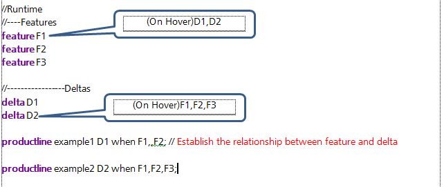

I am new to xtext and need some help. I have a problem statement and don't know how to implement the same. Below is a small example:
//Xtext Grammar---------
Feature_decl: 'feature' name=ID;
Delta_decl: 'delta' name=ID;
Product_line_decl: 'productline' name=ID delta=[Delta_decl|ID] 'when' feature+=[Feature_decl|ID]* (',' feature+=[Feature_decl|ID]*) ';' ;
//Runtime Result----------
feature F1 //on hover or click show D1 and D2
feature F2 //on hover or click show D1 and D2
feature F3 //on hover or click show D2
delta D1 //on hover or click show F1 and F2
delta D2 //on hover or click show F1, F2 and F3
productline example1 D1 when F1,F2; // Establish the relationship between feature and delta
productline example2 D2 when F1,F2,F3;
Now,I want to acheive the relation between features and delta declaration. When I click/hover on any feature say 'F1' anywhere in the program it should show depenedent deltas 'D1' and 'D2'. Similarly, when I hover over a delta say 'D1', it should show list of features i.e. 'F1' and 'F2'.

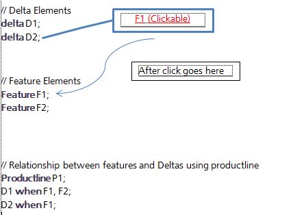

Re: Navigation on Hover. [message #1781708 is a reply to message #1781705] Mon, 12 February 2018 08:04 Go to previous messageGo to next message
Hello Christian,
I am using LabelProviders text method to display my customized values on hover. These values are basically the name of the element present in Xtext grammar. I want to know whether there exists a way using which I can navigate to the element declaration when I click on hover item i.e. I want to make the label of the text which displays on hover to be clickable.
Refer to the attach image.
Re: Navigation on Hover. [message #1781709 is a reply to message #1781708] Mon, 12 February 2018 08:07 Go to previous messageGo to next message
the question: what should a klick do.
navidate in the hover or the editor
[Updated on: Mon, 12 February 2018 08:08] by Moderator
Re: Navigation on Hover. [message #1781710 is a reply to message #1781709] Mon, 12 February 2018 08:16 Go to previous messageGo to next message
maybe somebody in the platform https://www.eclipse.org/forums/index.php/f/11/ or rcp https://www.eclipse.org/forums/index.php/f/106/ forum has an ide (problem should not be xtext specific)
Re: Navigation on Hover. [message #1781717 is a reply to message #1781710] Mon, 12 February 2018 09:08 Go to previous messageGo to next message
Hello Christian,
The hover labels of the elements are created by overriding the text(Element o) method of Xtext LabelProvider. This Xtext method takes String as the parameter. However, I want to display these values as a hyperlink so that user can click them and they can navigate to its declaration. Since Xtext label provider only offers a method to set the label as String. I want to know how can I pass a reference to the label instead of String.
Hope it is clear.
Re: Navigation on Hover. [message #1781723 is a reply to message #1781717] Mon, 12 February 2018 09:53 Go to previous messageGo to next message
<a href="xxxxx"></a> ??????
or a escaped version. have a look at javadoc/xbase hovers in xtend

Hello Christian,
I was able to find refrences and traverse the tree in a single file . However, I now need to find all the references of an element( an eobject) across multiple files. I am not able to find any suitable method. I also looked at "IReferenceFinder" but don't know how to use it. I have only the eobject and thus do not know how to find references using a eobject.
Thanks in advance.

Hi Christian,
I have the following grammar
//Goal Main Model OR Starting Rule
DomainModel: Compilation_Unit;
//Compilation Unit
Compilation_Unit:{Compilation_Unit} (deltaDecl+=Delta_decl)* (productline_decl=Productline_decl)? ('root' feature_decl+=Feature_decl |'extension' fextension+=Fextension)*
Product_line_decl: 'productline' name=ID delta=[Delta_decl|ID] 'when' feature+=[Feature_decl|ID] (',' feature+=[Feature_decl|ID]) ';' ;
The productline has the reference of features and Deltas. The features ,deltas and productline are defined in different files. I have implemented IHyperlinkHelper to customize the hyperlinking of the elements. I need to show the list of all Features related to a particular delta whenever the user (Ctrl+F5) on delta name. We can get this delta-feature information from the productline which is present in different file. I only have the eObject of delta as the user will (Ctrl+F5) on it . I need to get the reference of this delta from productline.
//-------------------Features (Features.abs)
feature F1
feature F2
feature F3
//-----------------Deltas (Delta.abs)
delta D1
delta D2
//Productline (Productline.abs)
D1 when F1,,F2; // Establish the relationship between feature and delta
D2 when F1,F2,F3;
When user Ctrl+F5, I need
D1->F1,F2
D2->F1,F2,F3
Currently, eObject.eContainer gives me Compilation_UnitImpl but I am not able to traverse the tree. I need to get the productline object from the delta eobject to show this linking. I am able to achieve it for a single file but for multiple file this is not working.
Thanks in adavnce.

I am not sure whether refrenceFinder will help me solve my problem. I have Injected IReferenceFinder referenceFinder and using referenceFinder.findAllReferences(delta,acceptor,monitor); but I am not sure from where I can get acceptor and monitor values and will this method will be able to fetch the references and help me in traversing the tree.
Re: Navigation on Hover. [message #1783305 is a reply to message #1783304] Sun, 11 March 2018 08:43 Go to previous messageGo to next message
You have to create the acceptor e.g. as anonymous class and use it to collect the redults
You should be able to pass a New nullprogressmonitor
Re: Navigation on Hover. [message #1783306 is a reply to message #1783305] Sun, 11 March 2018 08:49 Go to previous messageGo to next message
Will referenceFinder.findAllReferences will give me the references across the file. I want to use the references to get the parent where these references were used.
Re: Navigation on Hover. [message #1783307 is a reply to message #1783306] Sun, 11 March 2018 08:55 Go to previous messageGo to next message
Try it.
Re: Navigation on Hover. [message #1783313 is a reply to message #1783307] Sun, 11 March 2018 15:48 Go to previous messageGo to next message
I am now able to get the reference of the delta in other files. However, I want to get the references of the features present against the delta's reference .For example ,
My delta declaration are contained in Delta.abs and references are present in Productline.abs and I need to get the "F1,F2,F3" eobjects as they are referenced against D2 reference.
//-----------------Deltas (Delta.abs) declaration
delta D1
delta D2
//Productline (Refrence of delta)
How can I use my delta reference to do the traversal and get the other eobjects . Thanks in advance
