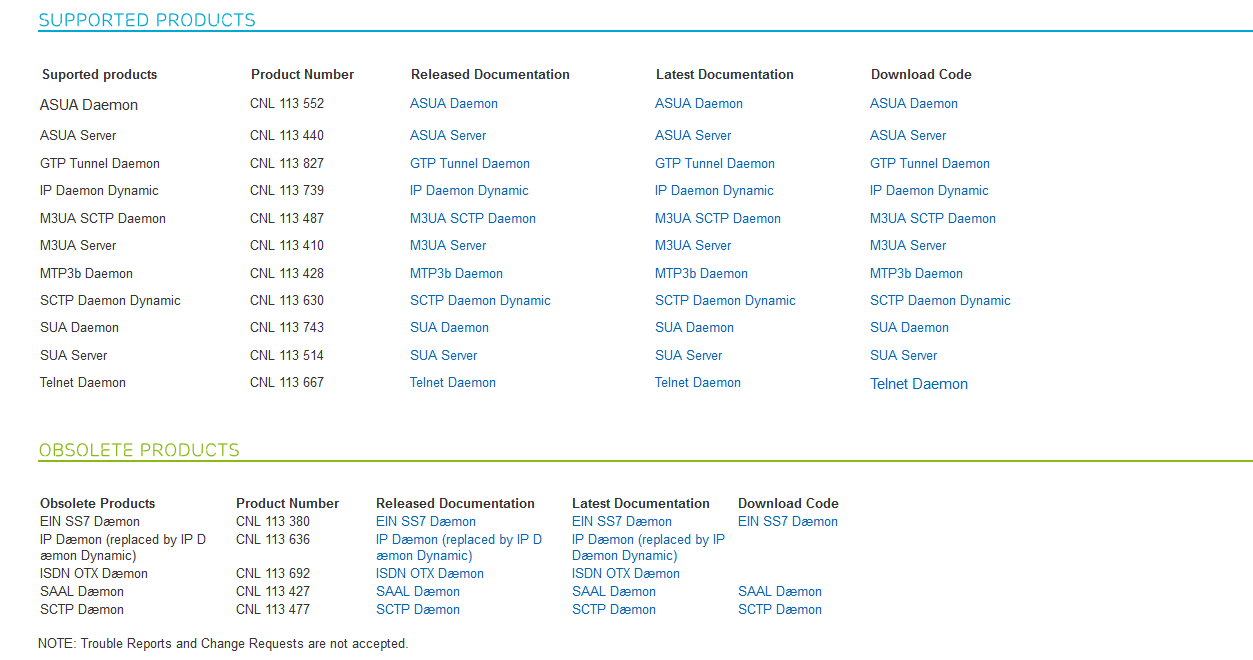

Right now , we have the below dameonic products:
index.php/fa/31881/0/
Please take a look and if interested I will check if I can make them open source.
