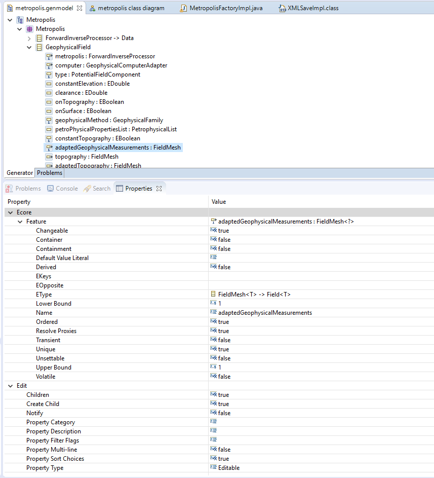

See the xmi file attached
and the genmodel image
Cheers

For example the FieldMesh of adaptedGeophysicalMeasurements is not saved as you can see in TonioReport.xmi text file!
This EReference is not declared transient?

I see what appears to be one cross reference that is serialized, i.e., topographySection="//@groups.6/@data.6" but I don't see that this serialization has 7 groups. Perhaps it's a broken proxy, i.e., you loaded the model, removed some objects from some containment references, but never resolved the cross references to that referenced contained object, nor did you try to clean up all cross references to remove references to the no-longer-contained objects (which in the generated editor is done automatically when an object is deleted from the tree.
In any case, the most likely reason that a cross reference isn't serialized is because the referenced EObject isn't contained by any Resource. Only references to objects contained by a Resource can be serialized. The following code could be used to debug this. I.e., it iterates over each object contained by the resource, iterates over each such contained object's cross references, and checks if the cross referenced object is a proxy or if it's not contained in a resource:
    for (TreeIterator<EObject> i = resource.getAllContents(); i.hasNext(); )
      for (EObject eObject : i.next().eCrossReferences())
        if (eObject.eIsProxy() || eObject.eResource() == null)
           // This is a) a broken proxy or b) a dangling reference

Thanks a lot Ed,
You are right using your code I discover that the EObjects are on dangling reference, and There is a good reason. I will debug the stuffs.
