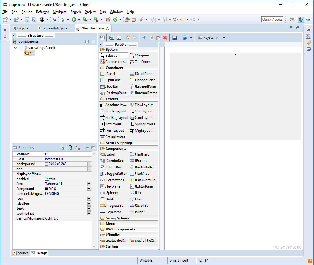

Eclipse Oxygen (4.7.2) & WindowBuilder (4.7) on Windows 10 with JDK 1.8.0_151
Can someone confirm? It appears to me that WindowBuilder ignores the *BeanInfo classes, apart from custom property editors and cistomizers.
Attached is a screen capture using the java code below.
First my bean class.
public class Fu extends javax.swing.JLabel {
    private String  bar;
    public String getBar() {
        return bar;
    public void setBar(String bar) {
        this.bar = bar;
Next my BeanInfo class.
public class FuBeanInfo extends java.beans.SimpleBeanInfo {
    public java.beans.BeanDescriptor getBeanDescriptor() {
        return new java.beans.BeanDescriptor(Fu.class);
    public java.beans.PropertyDescriptor[] getPropertyDescriptors() {
        java.beans.PropertyDescriptor[] propertyDescriptors = new java.beans.PropertyDescriptor[1];
        try {
            propertyDescriptors[0] = new java.beans.PropertyDescriptor("bar", Fu.class, "getBar", "setBar");
            propertyDescriptors[0].setHidden(true);
        catch (java.beans.IntrospectionException x) {
            propertyDescriptors = null;
        return propertyDescriptors;
As you can see in the screen capture, "bar" appears in the Properties table, even though in the "FuBeanInfo" class, it is set as hidden. I repeat, it appears that anything I do in the BeanInfo class is ignored, not just the "hidden" feature. For example also the "display name" is ignored. Only the "property editor" is not ignored. Am I missing something? Am I doing something wrong? Perhaps someone can point me to the relevant WindowBuilder code so that I can investigate the cause of this behavior?
