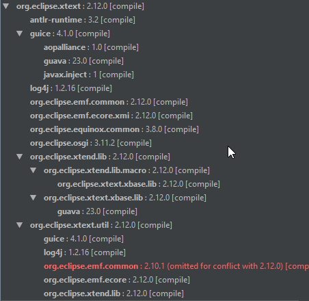

Currently I have an xtext maven project without plugin support, which I use standalone. I wonder about the many dependencies at runtime. Is it possible to reduce the dependencies? Need the project really guice, guava and xtend at runtime?
Re: xText Standalone maven dependencies [message #1779757 is a reply to message #1779756] Fri, 12 January 2018 04:46 Go to previous messageGo to next message
no you dont need xtend. but you dont use it. its just xtend lib.
and yes guice, guava and emf are needed
Re: xText Standalone maven dependencies [message #1779760 is a reply to message #1779757] Fri, 12 January 2018 04:57 Go to previous messageGo to next message
Do you know why guice is mandatory?
Re: xText Standalone maven dependencies [message #1779764 is a reply to message #1779760] Fri, 12 January 2018 05:24 Go to previous messageGo to next message
cause xtext relys on guice to do dependency injection.
Re: xText Standalone maven dependencies [message #1779772 is a reply to message #1779764] Fri, 12 January 2018 06:42 Go to previous messageGo to next message
Okay thanks.
I thought it's just for the injection during the code generation. And during the runtime xtext don't need it.

Christian Dietrich wrote on Wed, 17 January 2018 09:21
well xtend.core will use more than if you just youse xtext and its deps
And how you said xtext use DI itself, so i think you cannot get rid of the guice dependency.
e.g. i use the IResourceValidator to validate the resource and get the erros.
The ResourceValidateImpl use injection
Re: xText Standalone maven dependencies [message #1780097 is a reply to message #1780095] Wed, 17 January 2018 06:09 Go to previous message
yes
