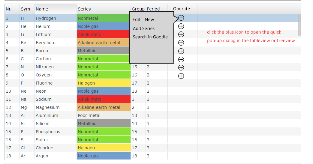

I want to make a quick pop-up dialog box in the tableViewer or treeviewer, and add some operation entrance to this dialog box, anyone can give a train of thought? and I drew a sketch map in the attachments.

you can use markup in table [1] and make the + sign image a RWT hyperlink that fires Selection event on the server. Based on this event you can open a pop-up menu with your options at given location.
[1] https://www.eclipse.org/rap/developers-guide/devguide.php?topic=markup.html&version=3.4

may be simple menu for rows?
Re: quick pop-up dialog in tableViewer [message #1779870 is a reply to message #1779852] Mon, 15 January 2018 01:46 Go to previous message
Considering the need to touch , I would not plan to use pop_up menus. Maybe a dialog without title can meet it, The best thing is like the picture shown above.
